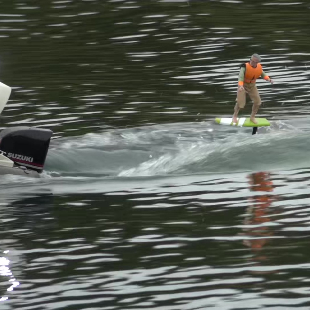

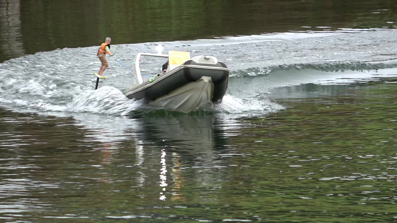

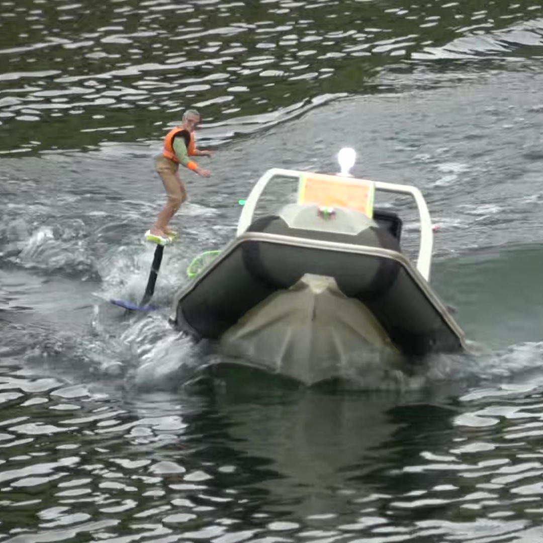

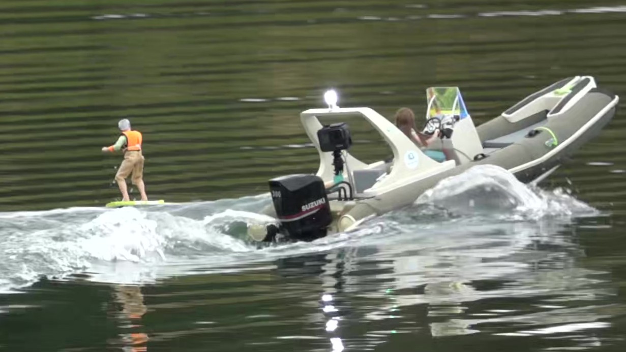

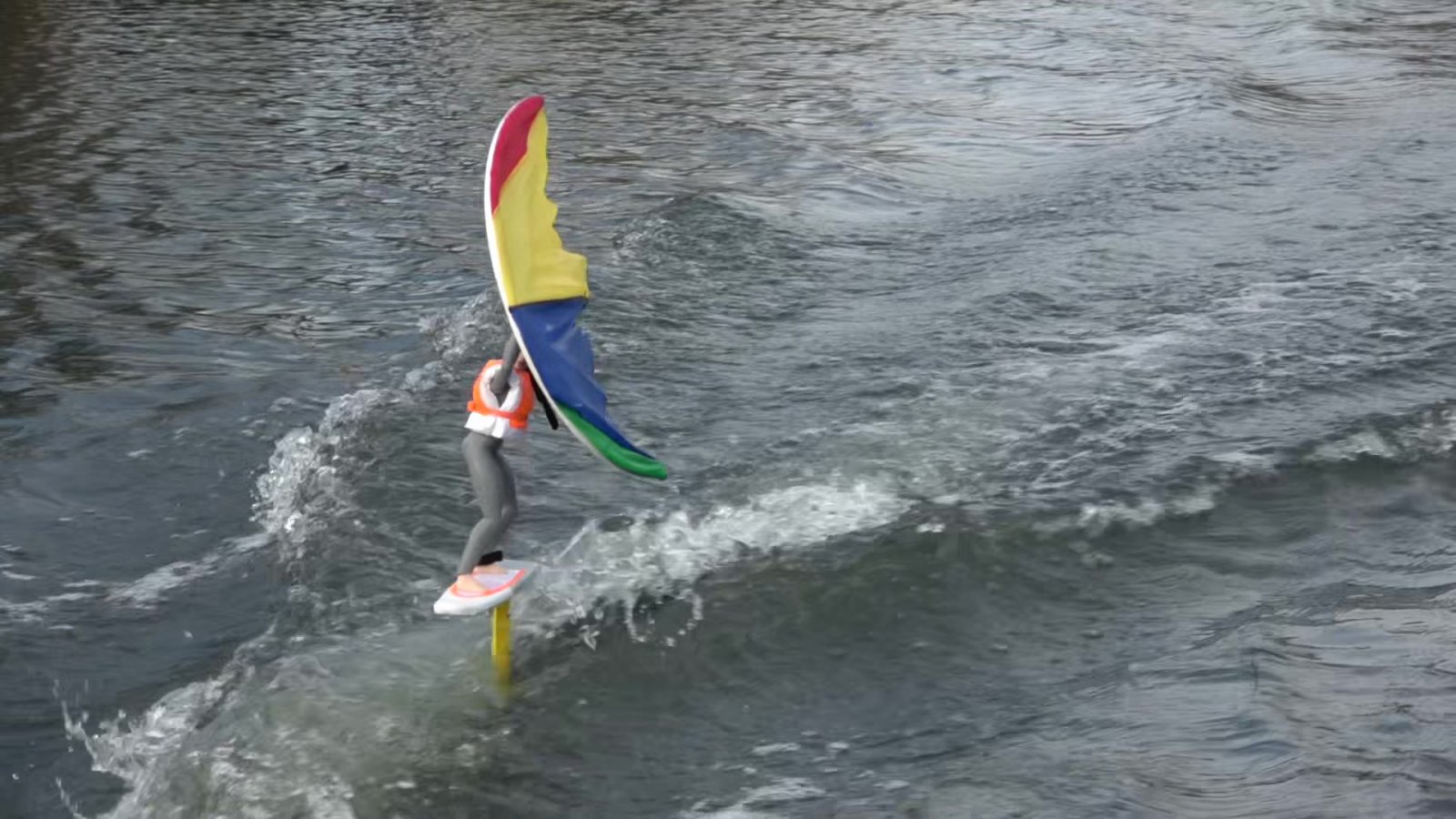

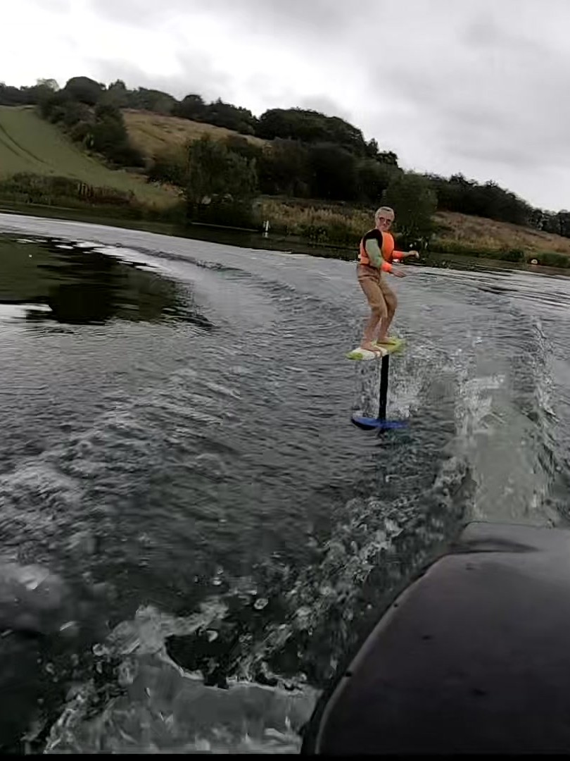

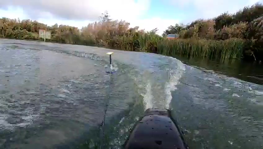

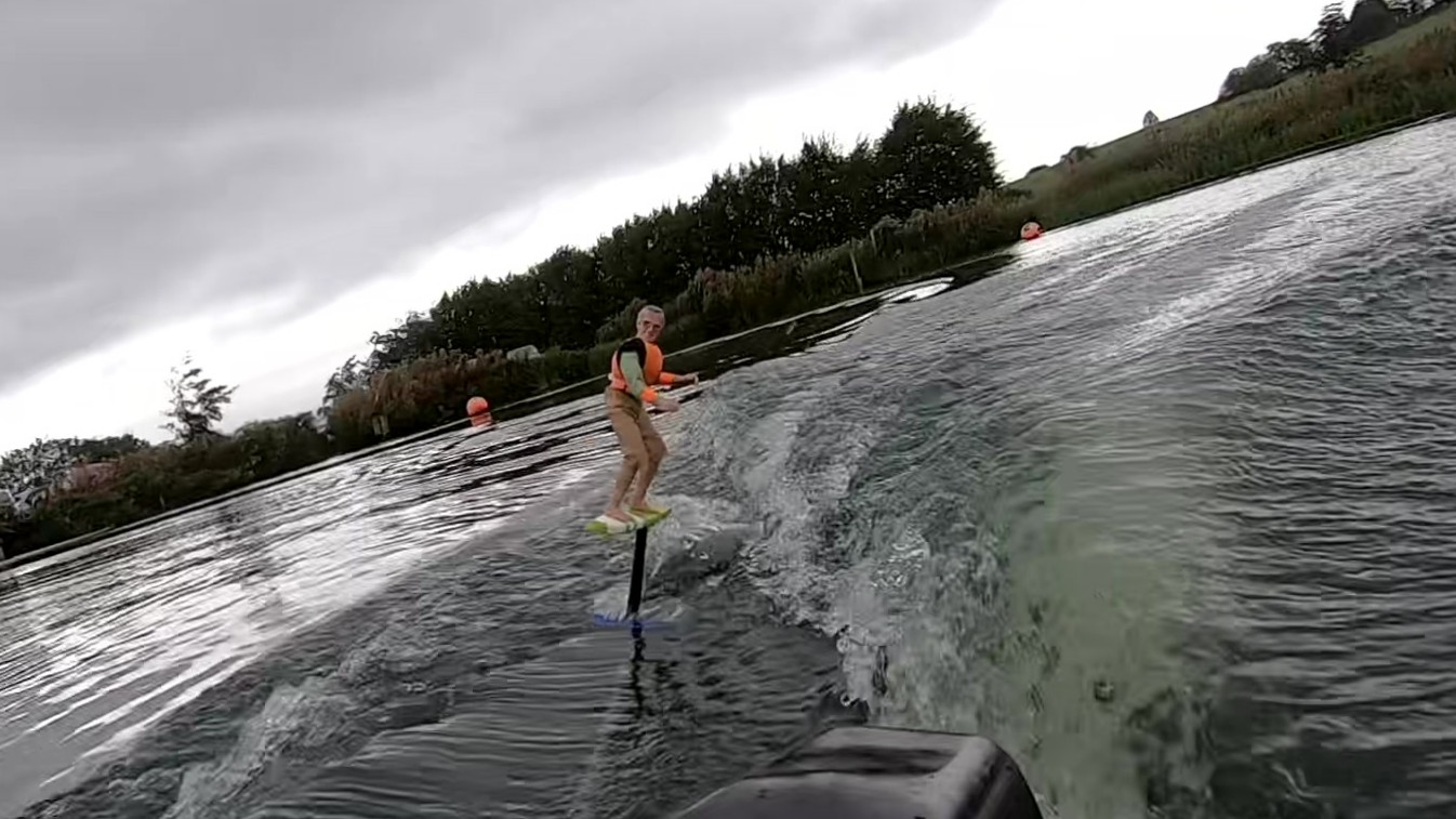

    Bad news first, the figure is much too heavy which kept it lying on its side, also the carbon tow tube was too small in diameter allowing a lot of flexing. Also the sliding tube idea didn't work too much friction, worse in water surprisingly. Finally too far from the boat, so not always hitting the wake. We went out in the club boat and I held the foil in the water minus the man and got some encouraging results, the faster Paul went the higher it lifted from the surface. So back onto my boat with camera running, good result again, see photos. So conclusion, the tow tube needs to be stronger and shorter, no need for sliding tube can be fixed solid, it also may need to be lower in the water. The figure could be too heavy, but worth trying again, maybe I can also reduce his weight. A more realistic position can be had for the mast, ie further back. The mast can be shorter as seen in photo too high out the water. It was interesting to see it sink down when it went behind the wake then rise up as it got back in front of it. YouCut_202_00_00_03_12-9-2024 05_32_52.jpg

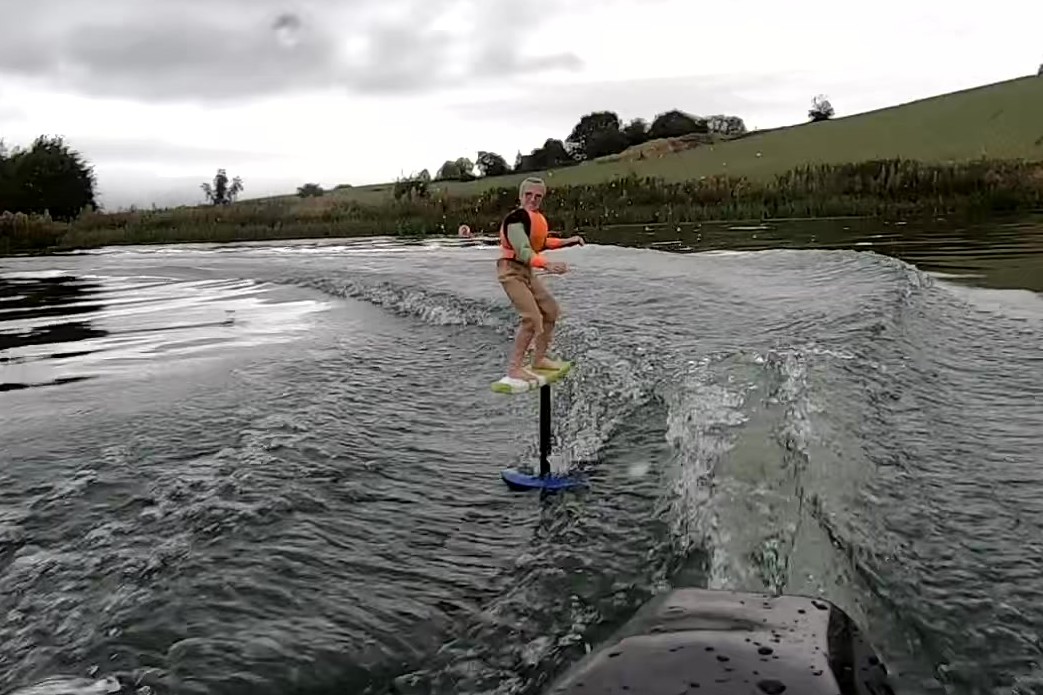

    CB foil su_00_01_35_16-9-2024 04_39_38_0.jpg 9 CB foil su_00_01_35_16-9-2024 04_39_38_0.jpg CB foil su_00_01_03_16-9-2024 04_39_05_0.jpg CB foil su_00_00_44_16-9-2024 04_38_47_0.jpg CB foil su_00_00_34_16-9-2024 04_38_37_0.jpg CB foil su_00_00_40_16-9-2024 04_28_49_0.jpg CB foil su_00_03_44_16-9-2024 04_18_53_0.jpg

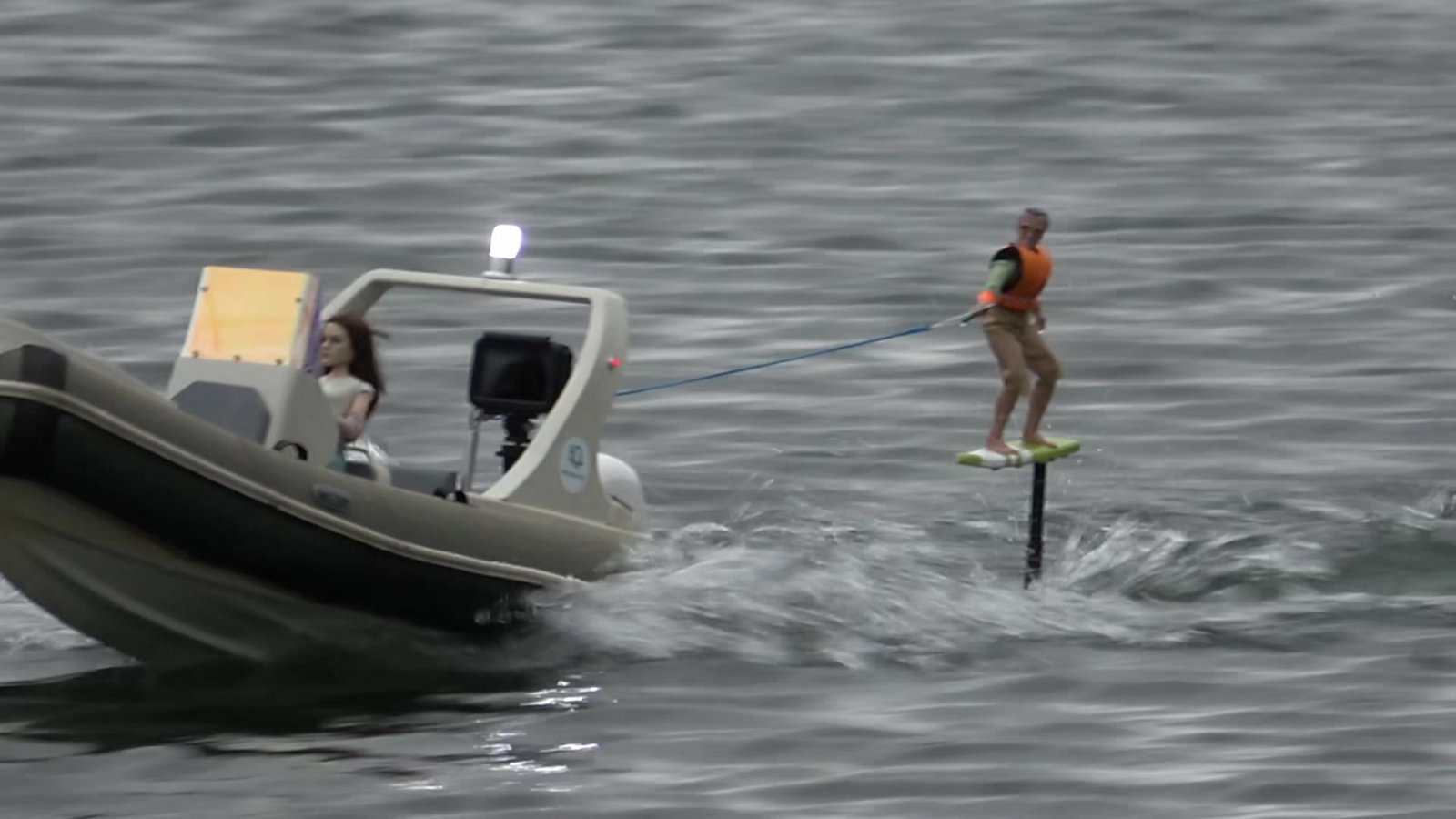

    Pleased with the result, worked first time. Later in day I had to go out and rescue him when the glue gave way.

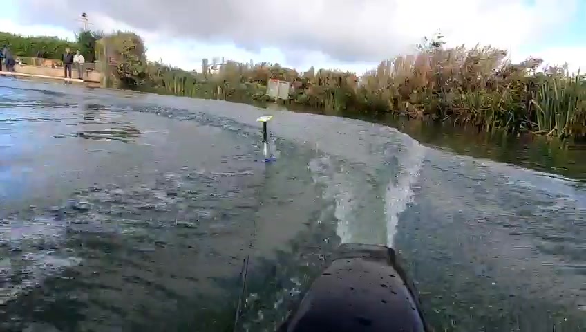

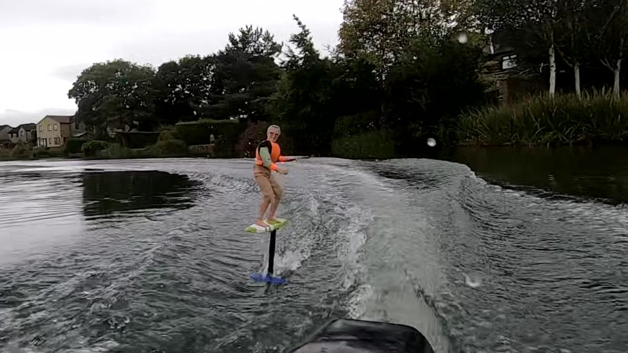

    Thanks Michiel. CB24 Wave_00_02_20_19-9-2024 05_46_01_0.jpg CB24 Wave_00_02_20_19-9-2024 05_46_01_0.jpg CB24 Wave_00_01_14_19-9-2024 05_44_54_0.jpg CB24 Wave_00_00_48_19-9-2024 05_44_28_0.jpg

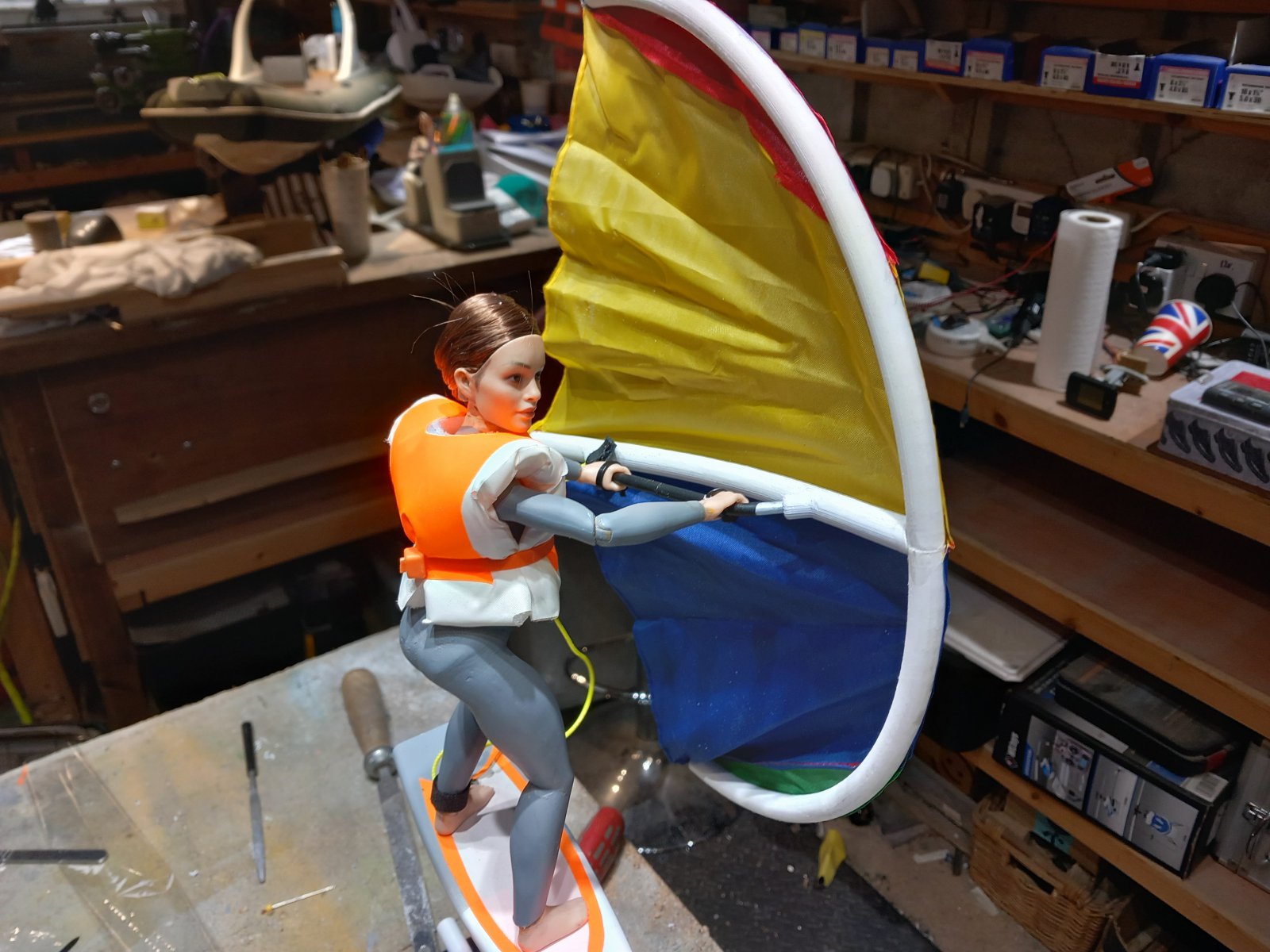

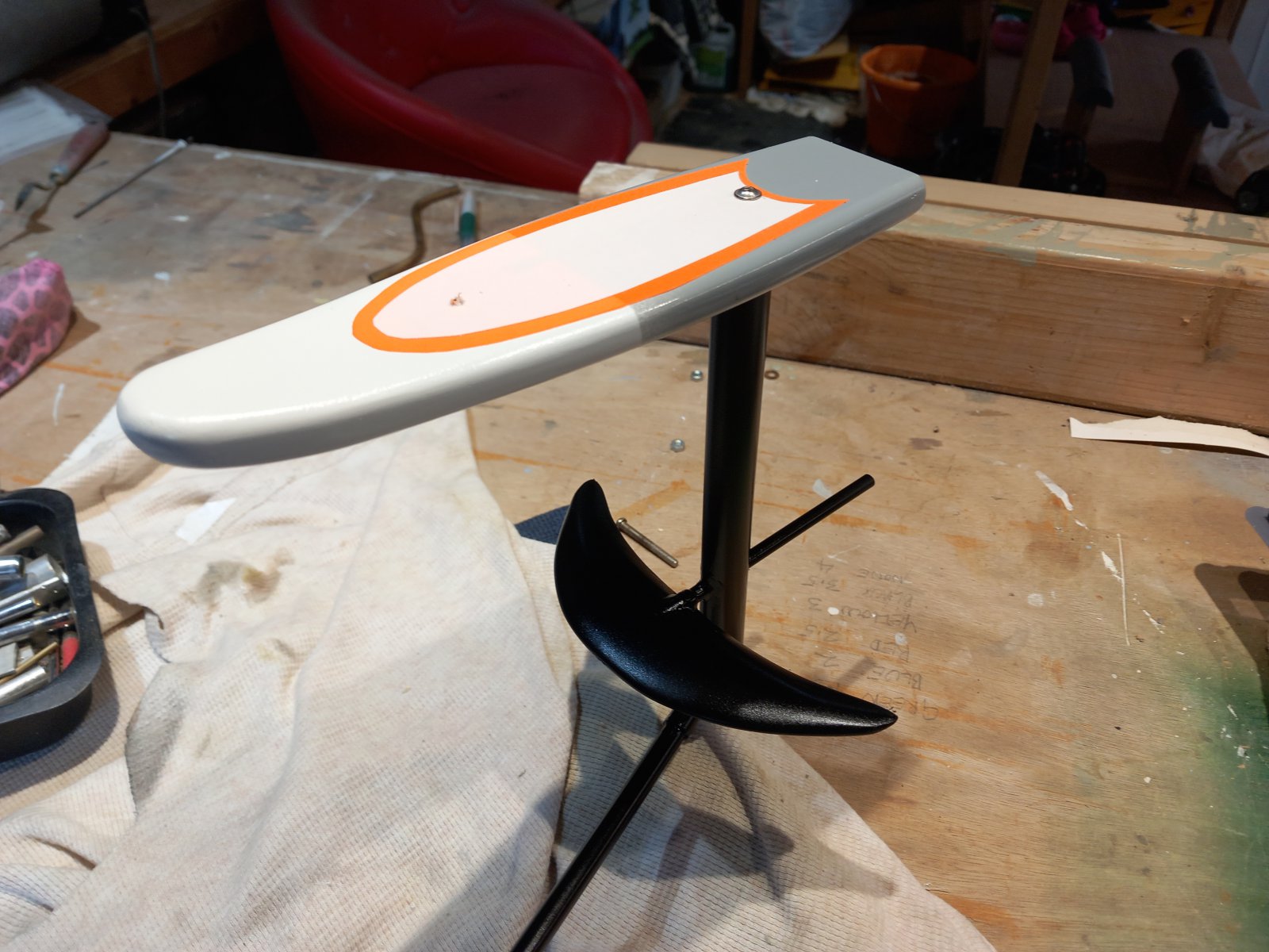

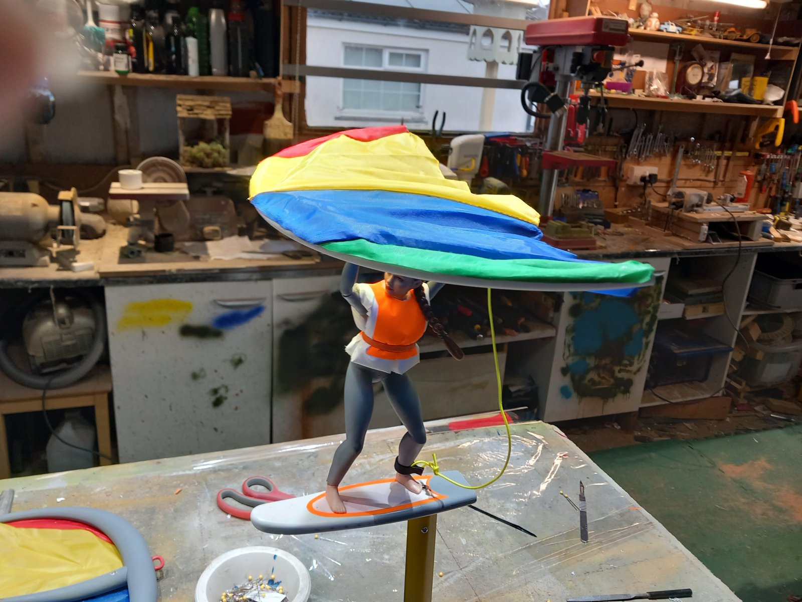

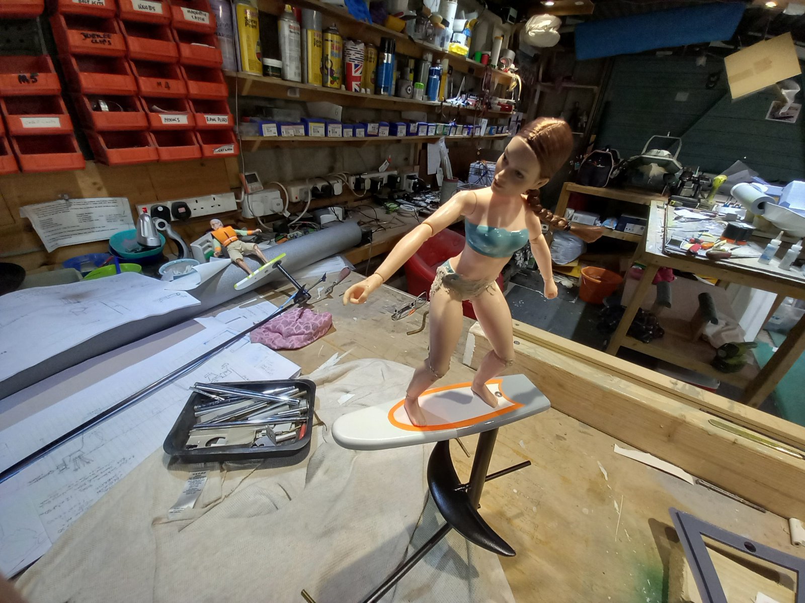

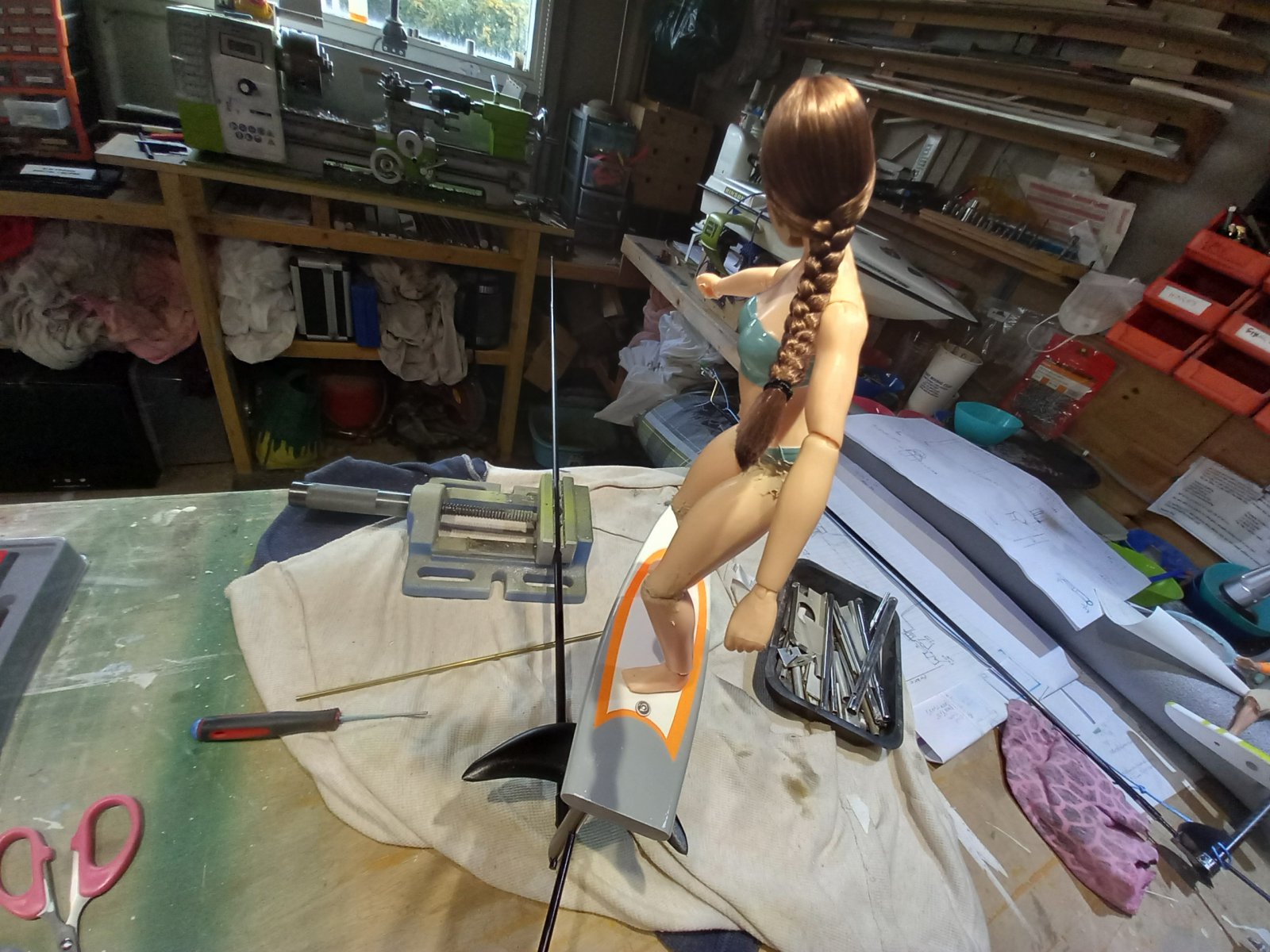

    Working on a bigger version plus 33%...... 20240927_170030.jpg 20240927_165949.jpg 20240927_162345.jpg Started on the figure, chopped 20mm of lower leg, then drilled 5mm for brass tube, bent to the right angle. The feet also cut at an angle are pinned with 2mm brass rod. I think I'll paint her grey to look like a wet suit then add a life jacket, running short on orange dacron though. She is free standing on the board so the balance is good, two 2mm screws into her feet should fix her in place. Do I need to shorten her arms, not made my mind up yet. Also having to decide how long to make the tow tube, at the moment it's 1300mm, the smaller one was 800mm. 1200mm sounds about right.

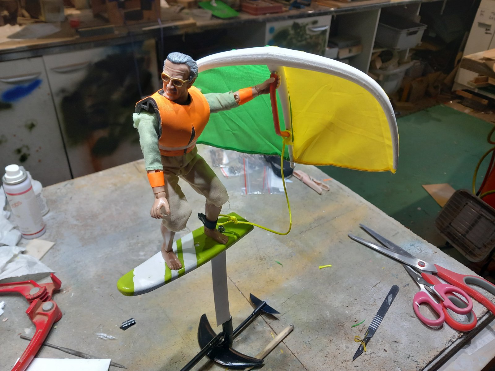

    This is Stan again, the bigger version won't be long now. Stan 3_00_02_12_09-10-2024 20_46_28.jpg Stan 3_00_01_46_09-10-2024 20_46_02.jpg Stan 3_00_01_29_09-10-2024 20_45_45.jpg Stan 3_00_00_58_09-10-2024 20_45_15.jpg

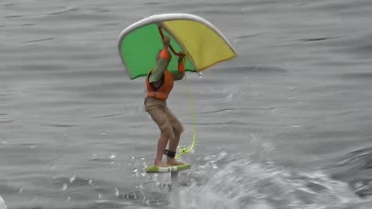

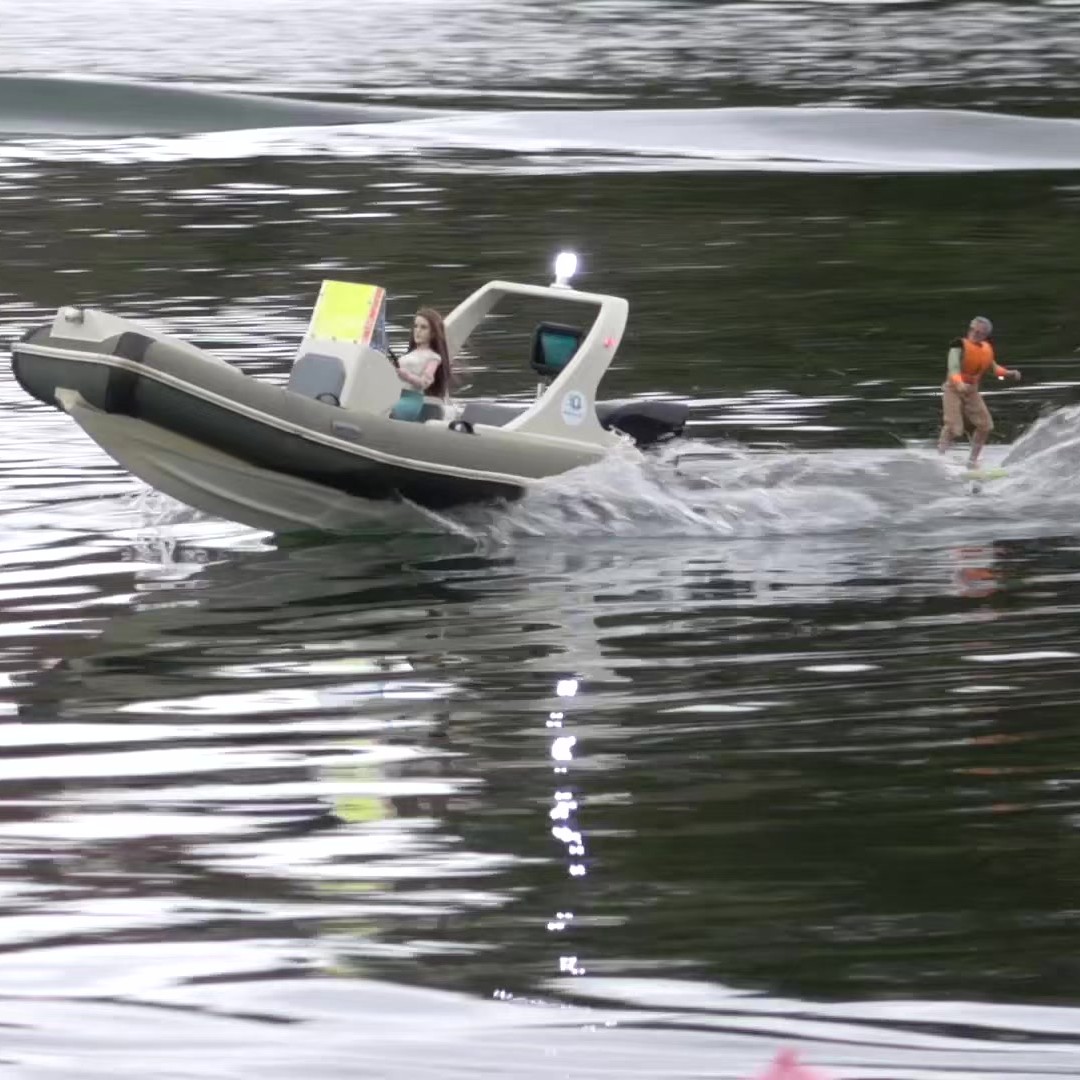

    This small wing suits Stan better as he is at a smaller scale, shame to waste it. Stan was my first try at wake foiling behind my scratch built RC rib. I’ve given him a safety line in case he lets go of the wing. [​IMG]

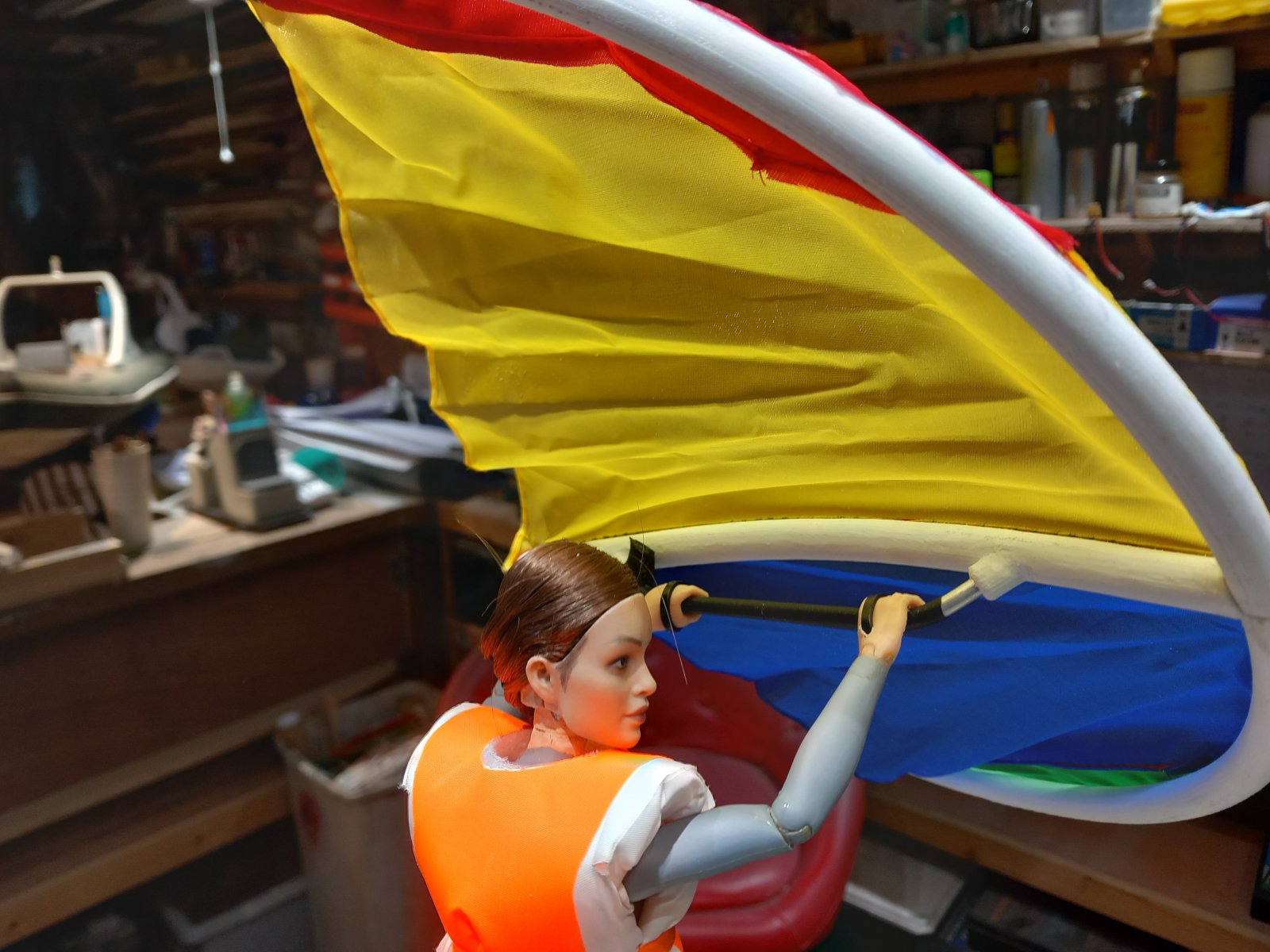

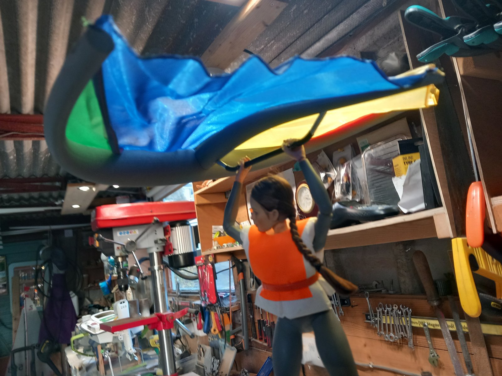

    This wing will be 320mm across, to suit Katerina. Should be quite a sight on the water if it works, it will need to overcome the drag of water and get airborne. 20241101_140237.jpg

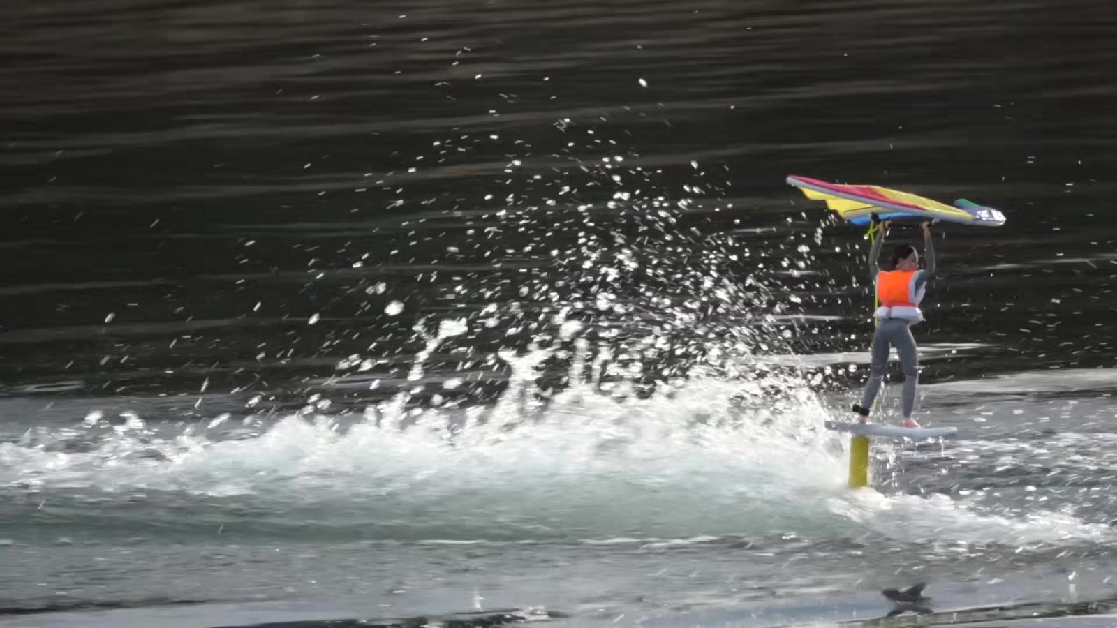

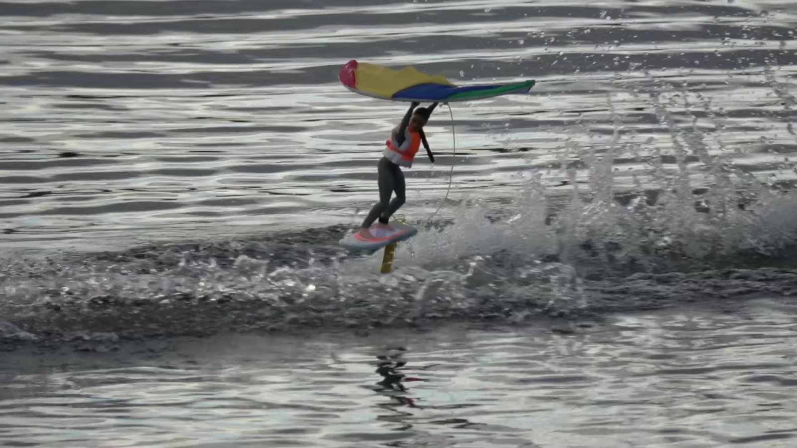

    Wing foiling

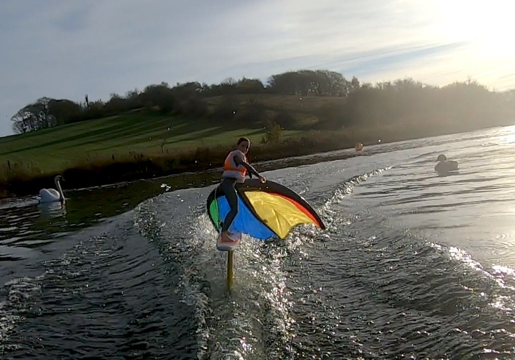

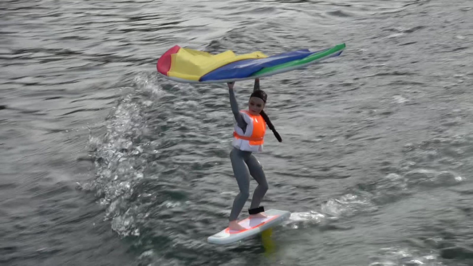

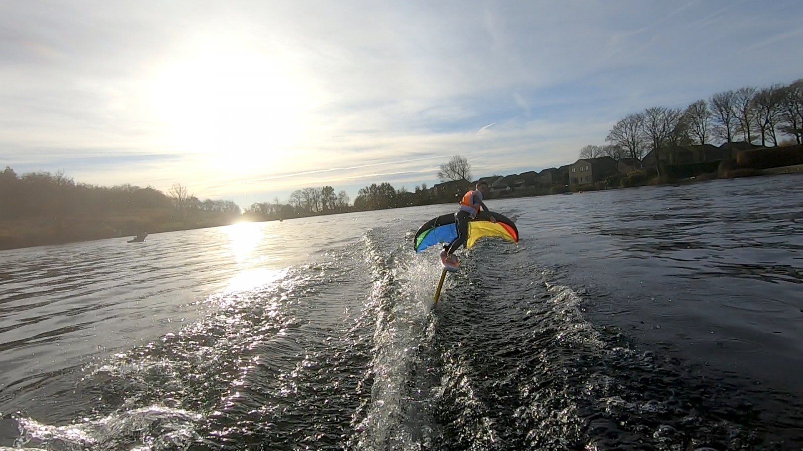

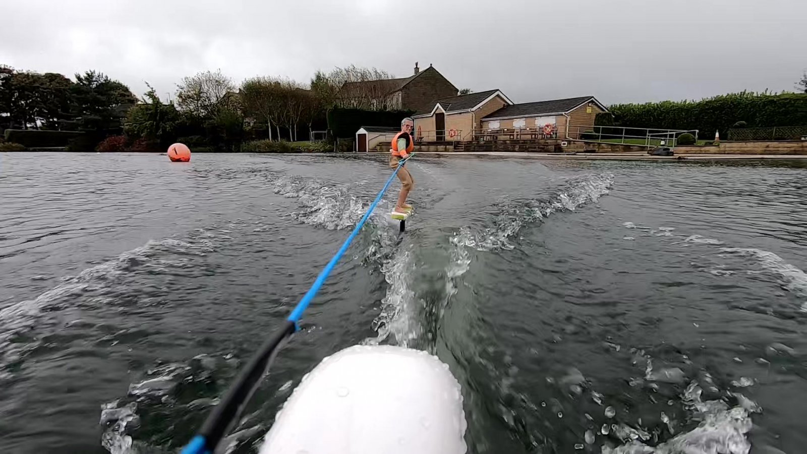

    Stan did well at wing foiling, never let go of the wing and never fell off. Better to show you still photos to keep the illusion going.
    Today it's Katerina to try with her much larger wing, light winds forecast probably just as well for her first try. CB24 Stan_00_01_04_13-11-2024 05_31_27_0.jpg CB24 Stan_00_01_02_13-11-2024 05_31_25_0.jpg CB24 Stan_00_00_54_13-11-2024 05_31_17_0.jpg 20241112_153642.jpg

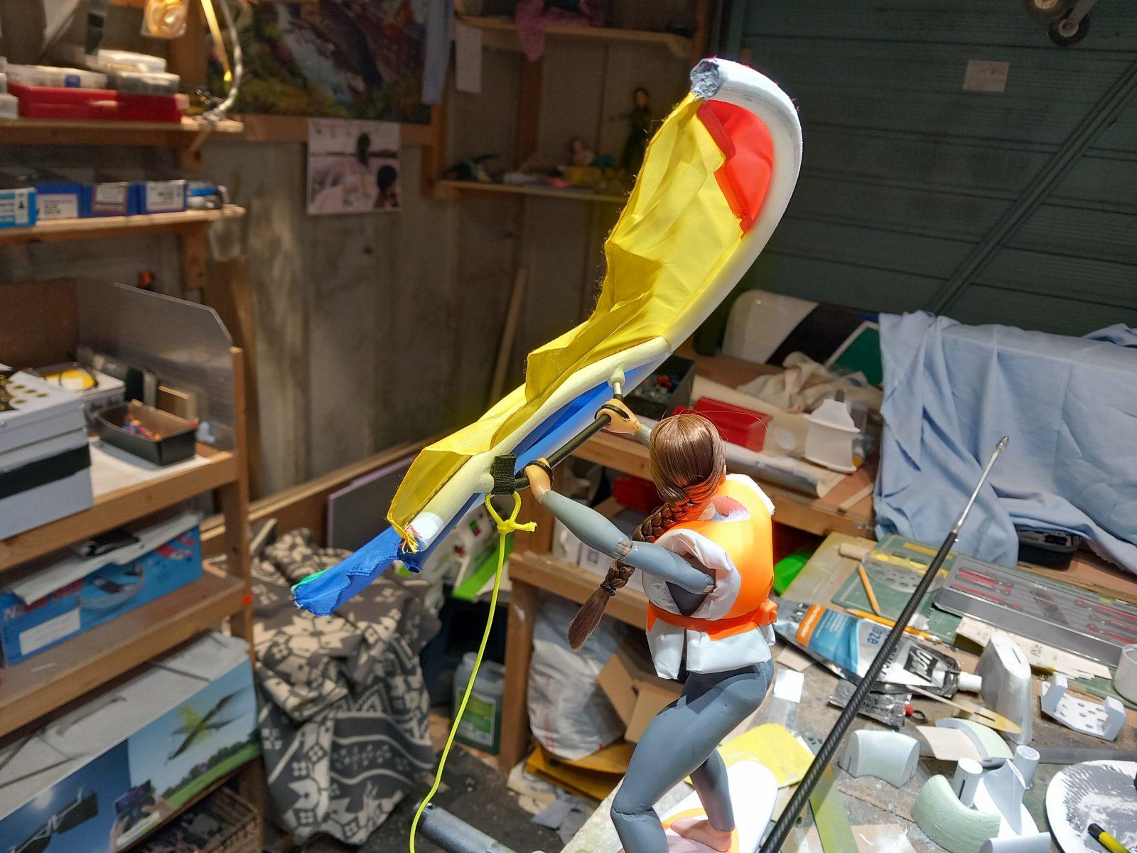

    This wing was too heavy so decided to start again and make it much lighter

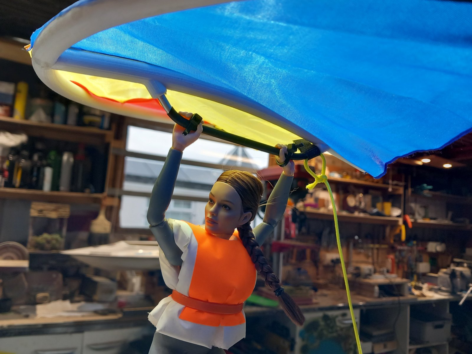

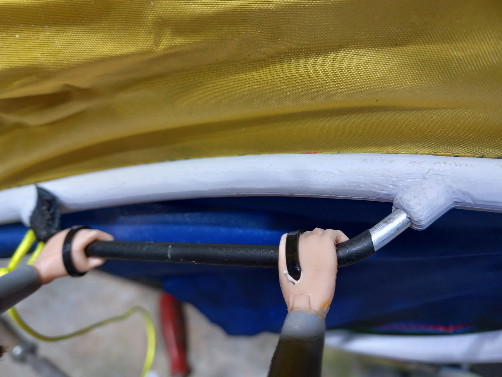

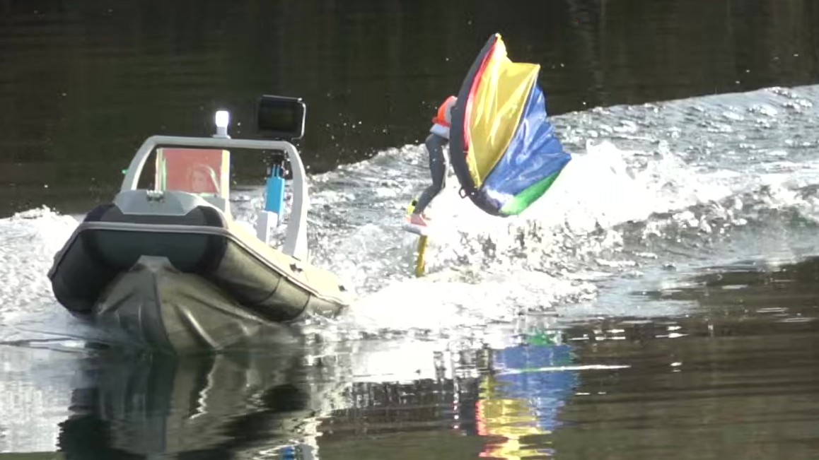

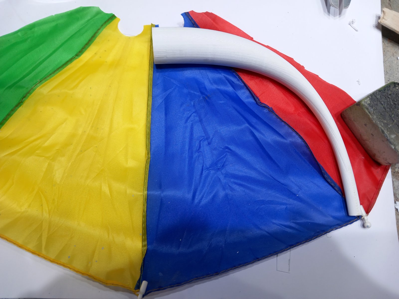

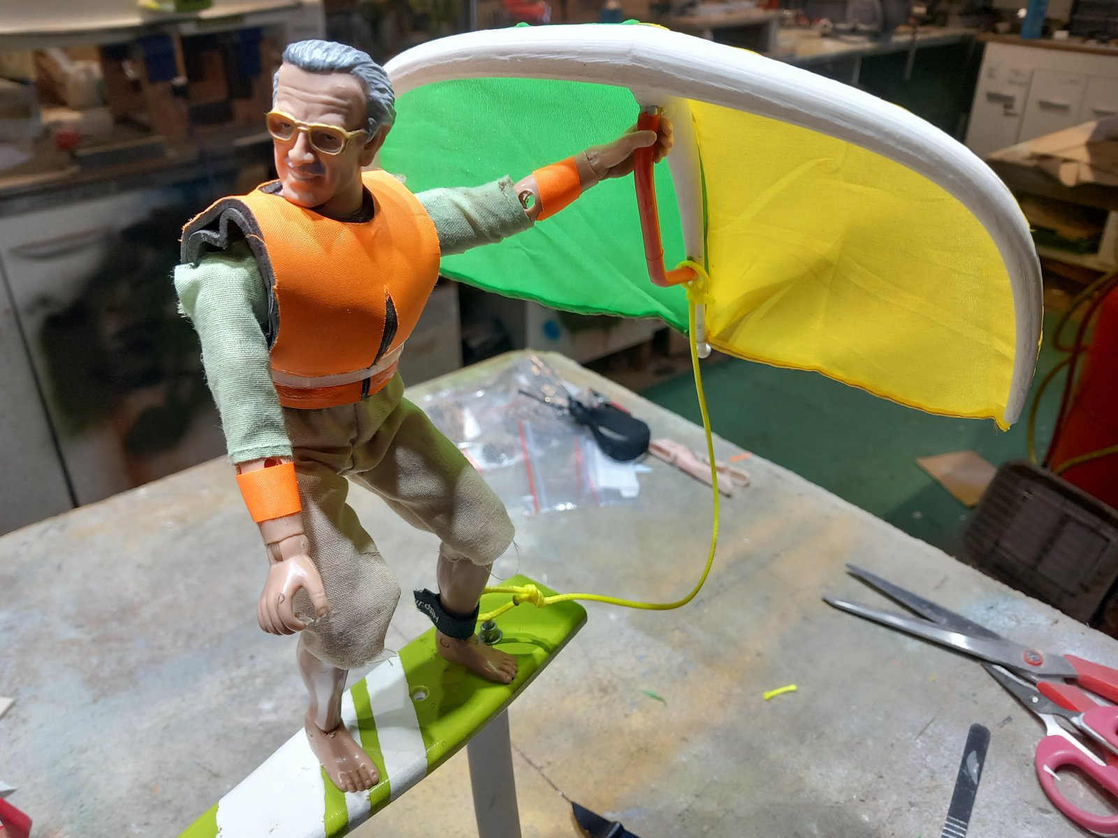

    Wow got the weight down from 140grams to just 45 grams , she has a firm grip now too thanks to me drilling through her hand for a small tie strap. Then I super glued her wrist and elbows, so the wing rotates around her shoulders. So the wing is the same size just smaller section and printed hollow using shell command, giving 2mm thick walls. The handle has been given bosses into which it is sprung into place without glue. Feeling confident for Sunday to make a you tube film.

    . This is the heavy wing

    The new wing.
