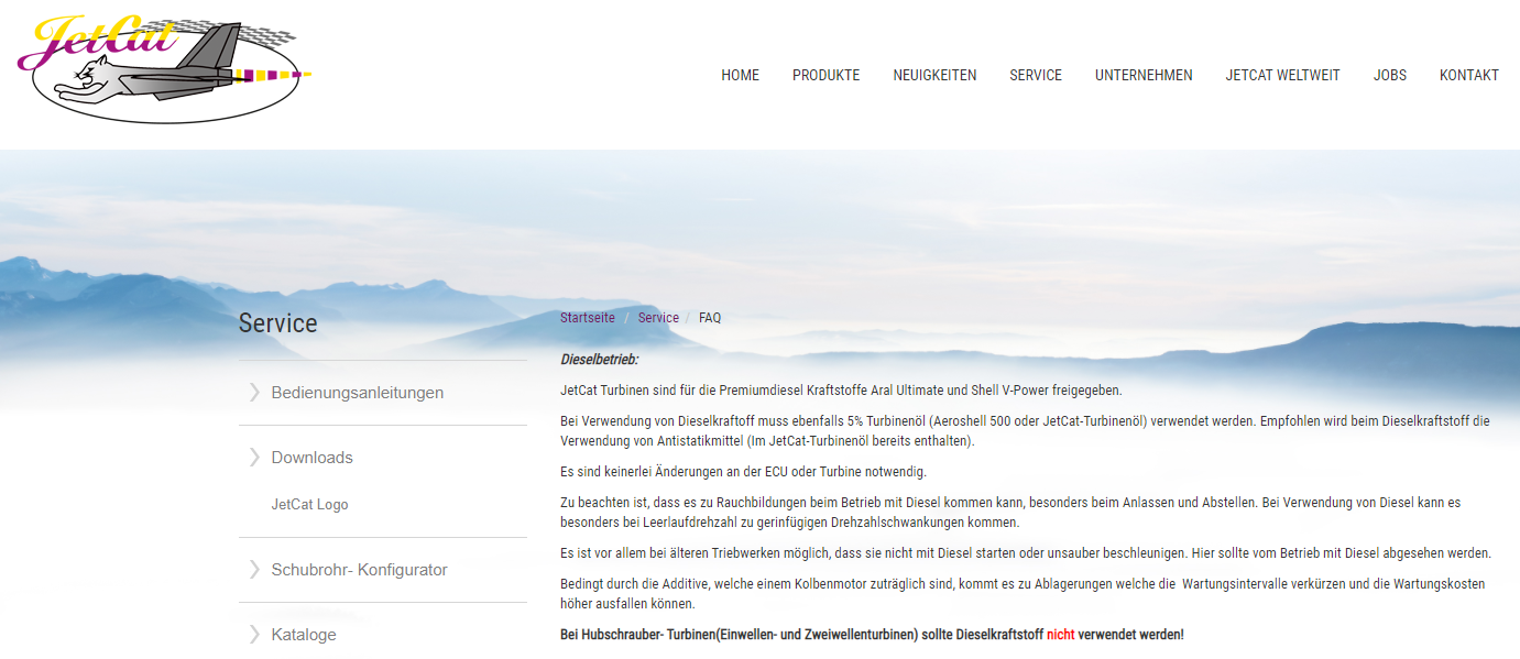

    JetCat info

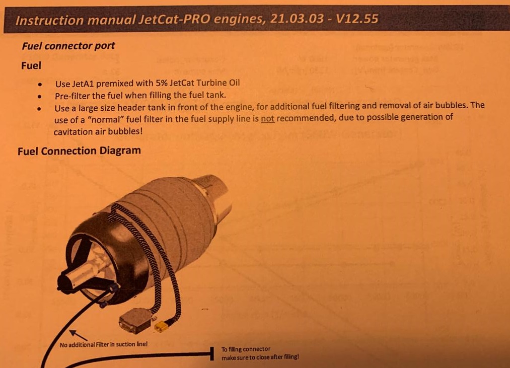

    Uit JetCat P250 PRO-S manual:
