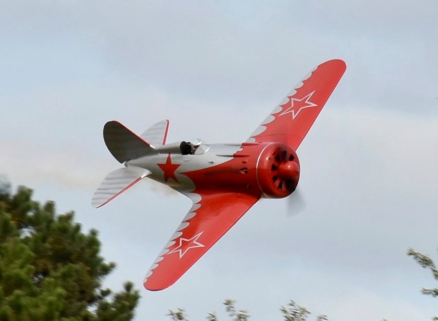

Online artikel Model Airplane News, September 15, 2020:
"The Polikarpov I-16 (Russian: Поликарпов И-16) was a Soviet single-engine single-seat fighter aircraft of advanced design; it was the world’s first low-wing cantilever monoplane fighter with retractable landing gear to attain operational status, and as such “introduced a new vogue in fighter design. The I-16 was introduced in the mid-1930s and formed the backbone of the Soviet Air Force at the beginning of World War II.
Its main opponent in the sky in 1941 was the German Messerschmitt Bf 109.The I-16 was slightly more maneuverable than the early Bf 109s and could fight the Messerschmitt Bf 109E, or Emil, on equal terms in turns. Skilled Soviet pilots took advantage of the Polikarpov’s superior horizontal maneuverability and liked it enough to resist the switch to more modern fighters. The German aircraft, however, outclassed its Soviet opponent in service ceiling, rate of climb, acceleration and, crucially, in horizontal and diving speed, due to better aerodynamics and a more powerful engine.
Known for building and flying out of the ordinary aircraft, Sal Calvagna’s newest RC warbird is the Polikarpov I-16. For a more flashy appearance, Sal finished the Soviet warbird in the Stalin’s “Red Five” Aerobatic team color flown by Soviet Ace Valery Chkalov, Hero of the Soviet Union.
Sal built his I-16 from YRM plans from The Netherlands, and features traditional balsa, lite ply and balsa construction.
Sal’s 88 inch span I-16 is powered by a Zenoah GT-80 twin cylinder gas engine, is controlled with Futaba radio gear, and features modified Robart retractable landing gear. Sal even made the scale engine cowling from fiberglass and finishing resin using the “lost foam” technique using several layers of 4- and 6- ounce glass cloth.
Sal test flew the I-16 recently and all went extremely well.
A little tweak to the balance is required and some more finer details have to added, but Sal says the Polikarpov I-16 flies great!"

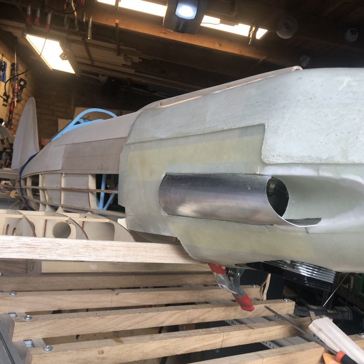

Ondertussen wordt er nog een Mig 3 gebouwd in Nederland, centraal in het land (niet bij ons) en Martin (de bouwer) gaat letterlijk als een speer en pakt ook maar gelijk wat schaaldetails aan voor in het toestel.
We mogen daarbij zeggen dat de ervaring in de RC in principe ver onder het gemiddelde van hier ligt, echter wat hij doet gaat super en er is veel ruggespraak met Jeroen en mij.
Martin verdiept zich eerst in de materie (komt ook deels door zijn werk) alvorens hij gaat plakken.
Het resultaat tot op heden mag er zijn.
Ja, jan heeft weer even wat te . . .
De volgende bouwer moet niet van die rare strepen over de kielvlakken airbrushen!
(Kan me niet voorstellen dat de echte die ook had . . .)
Verder is het inderdaad een erg gaaf model! :thumbsup:
jan.

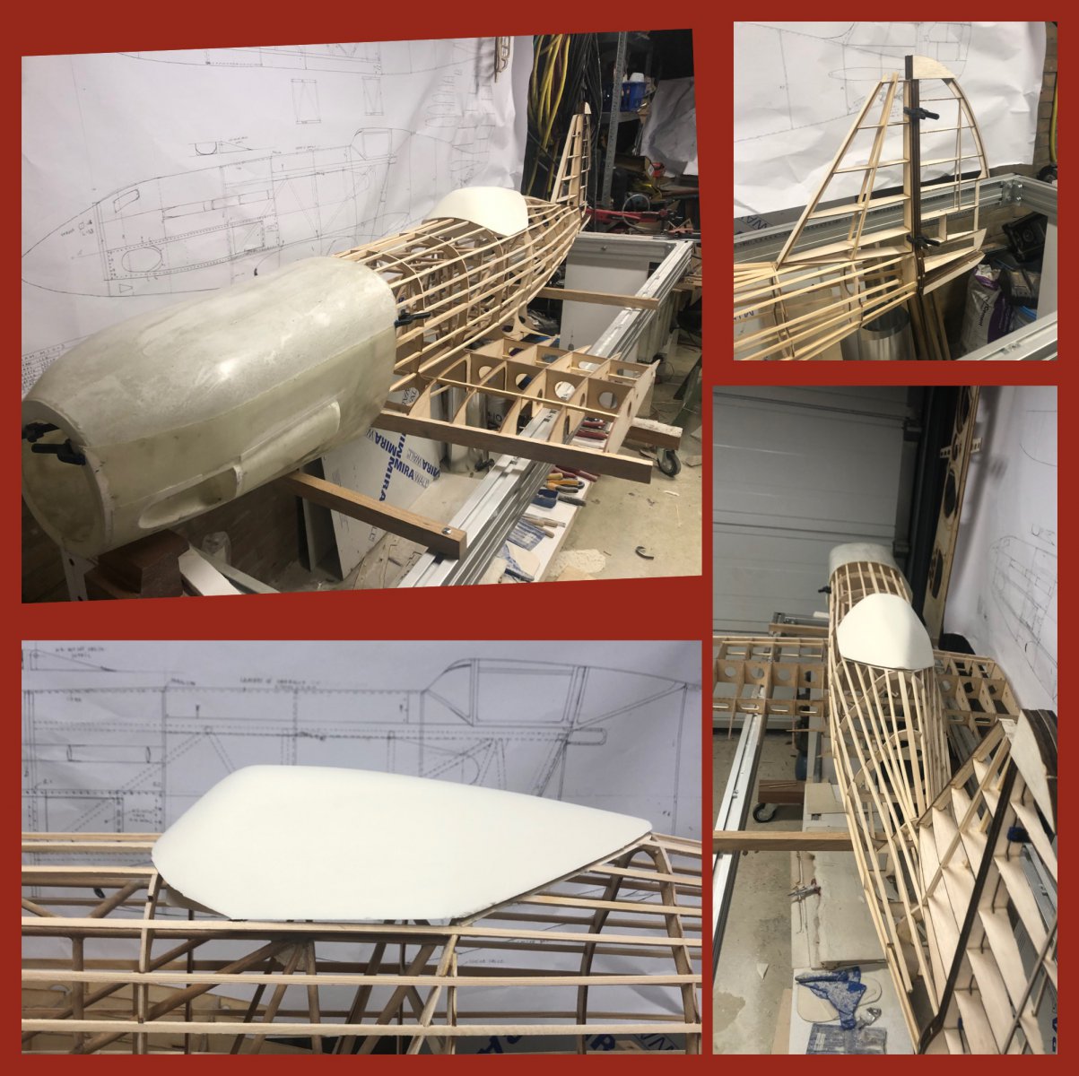

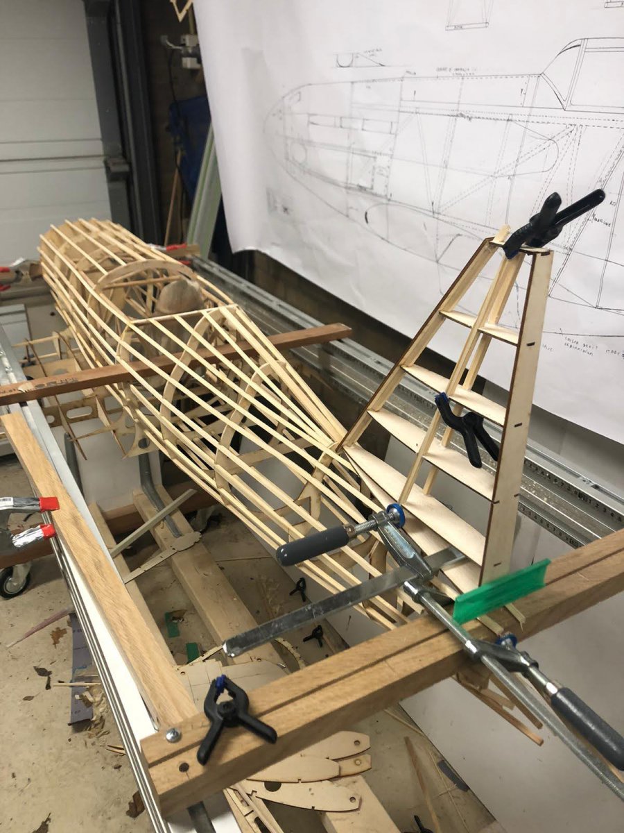

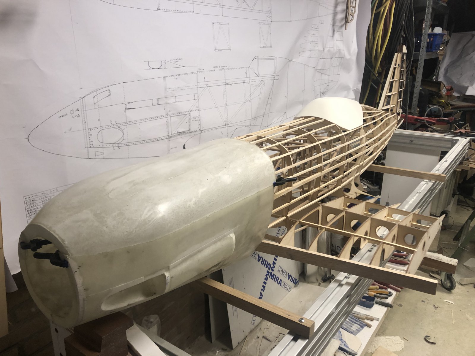

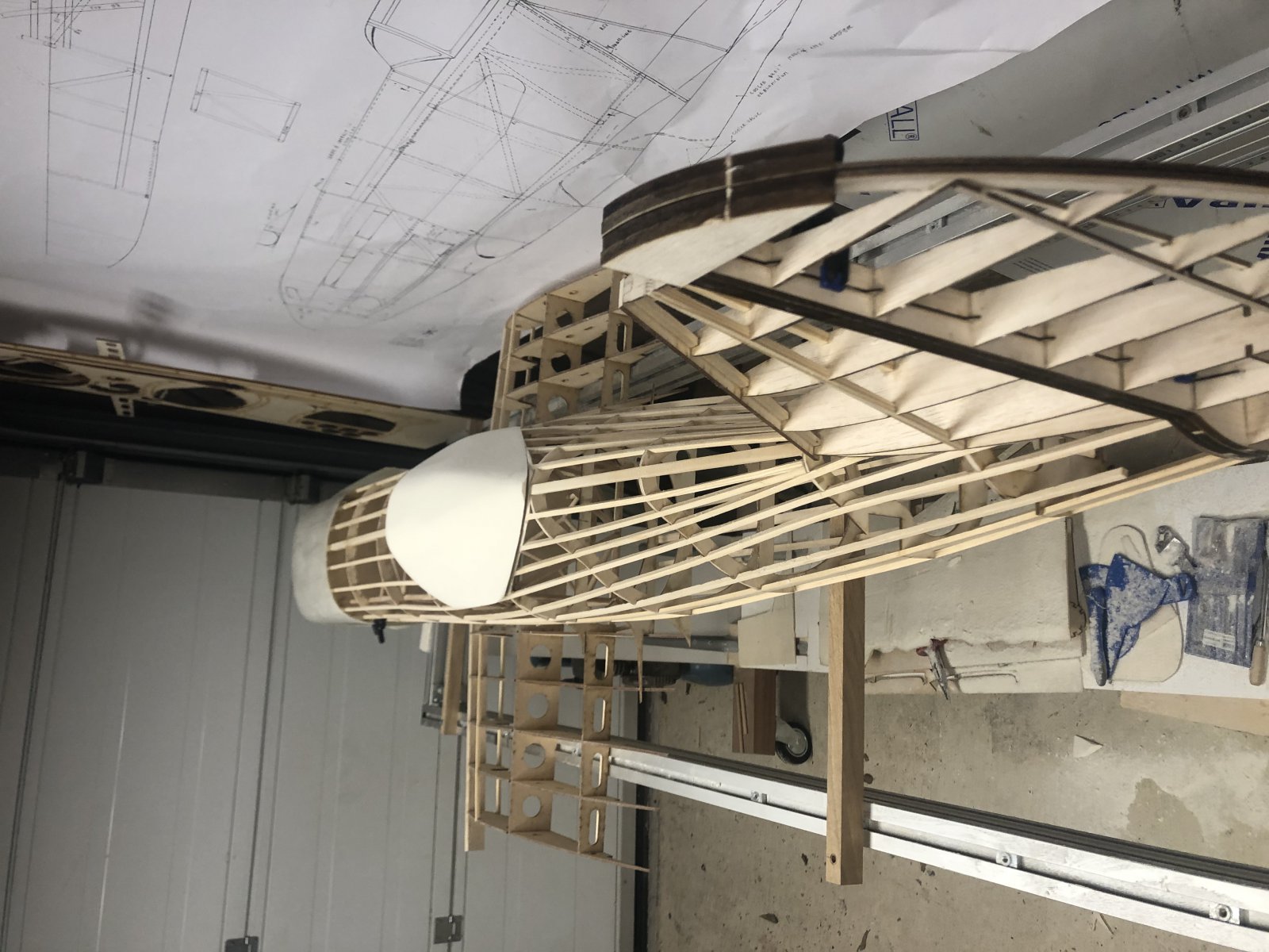

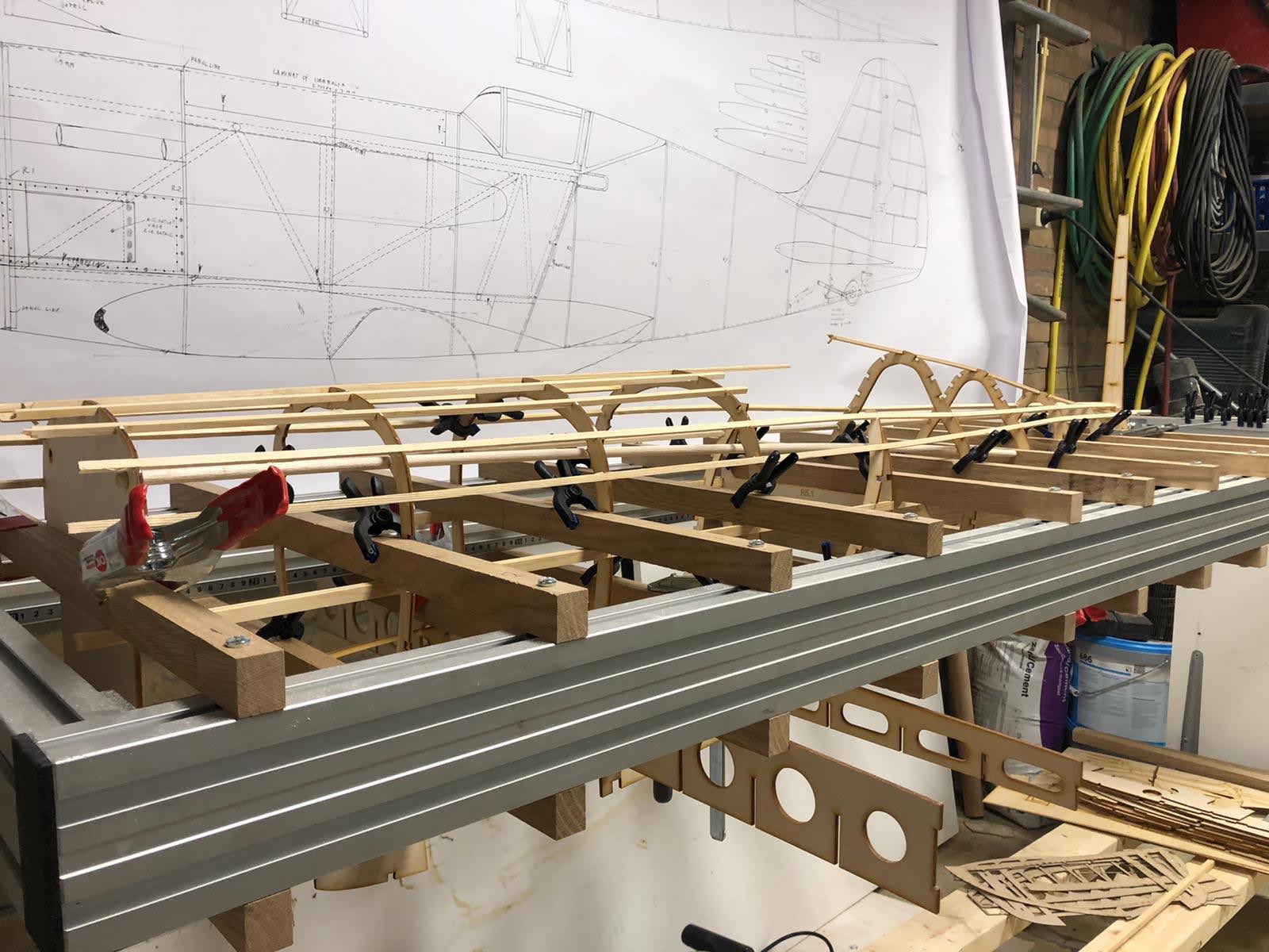

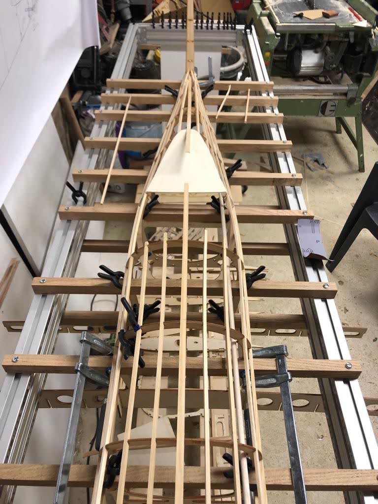

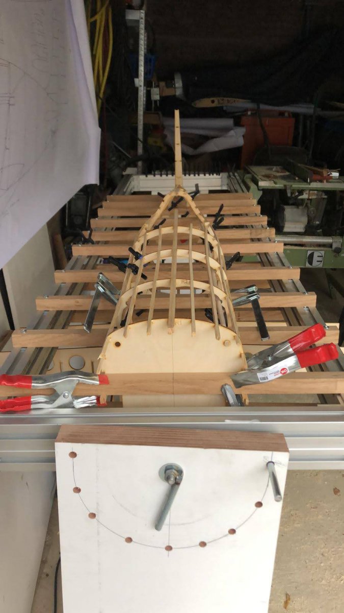

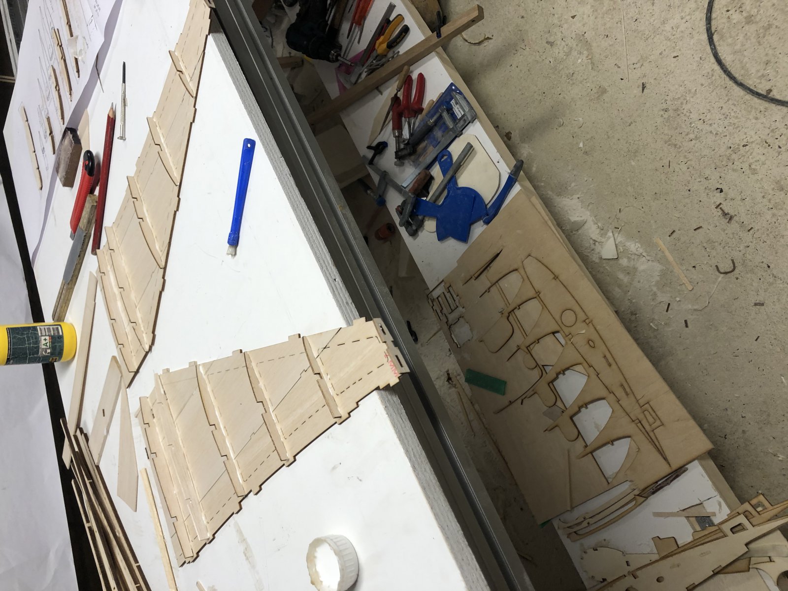

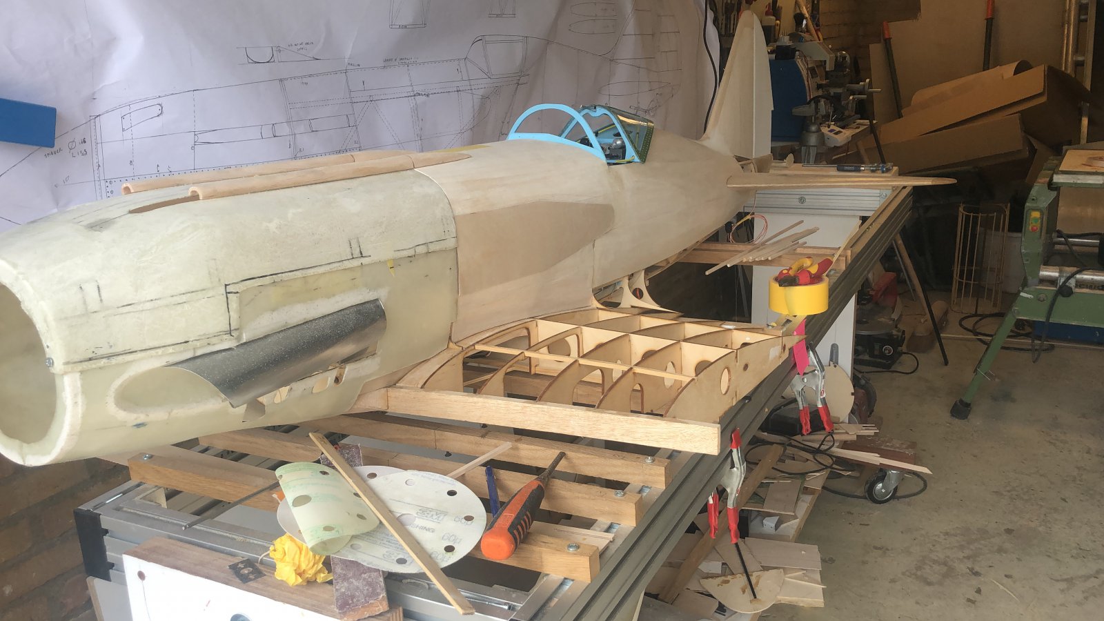

Die bouwhelling is een luxe frame, gemonteerd als een spit met uit mijn hoofd stappen van 30 graden waaronder hij hem kan locken, aan 2 zijden de dwarsbalkjes kunnen monteren en nog wat extra's. Is ook onderdeel van zijn werk. Ik zal vragen of hij hier voor de liefhebbers eea kan en wil plaatsen.
Updated Mig3
Voor heel eventjes uit het frame,
Dan weer terug en verder alles af en inbouwen

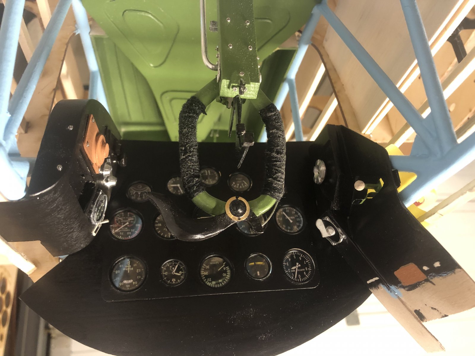

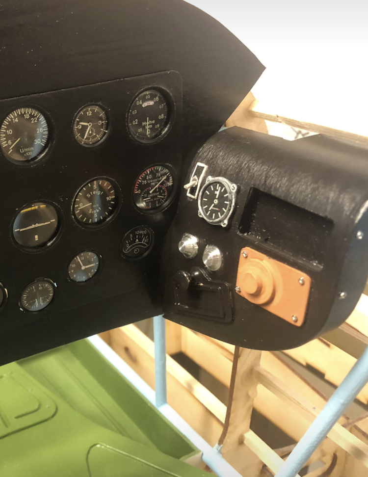

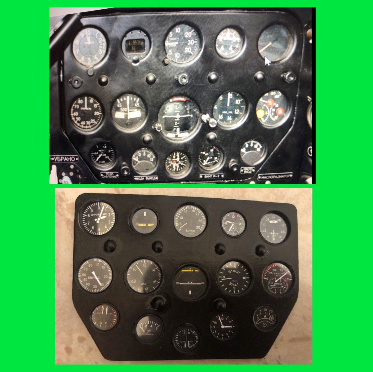

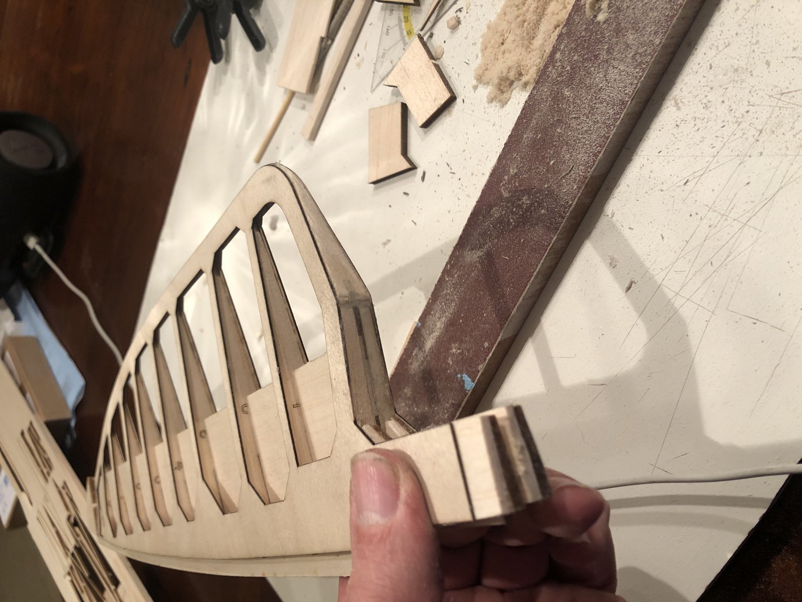

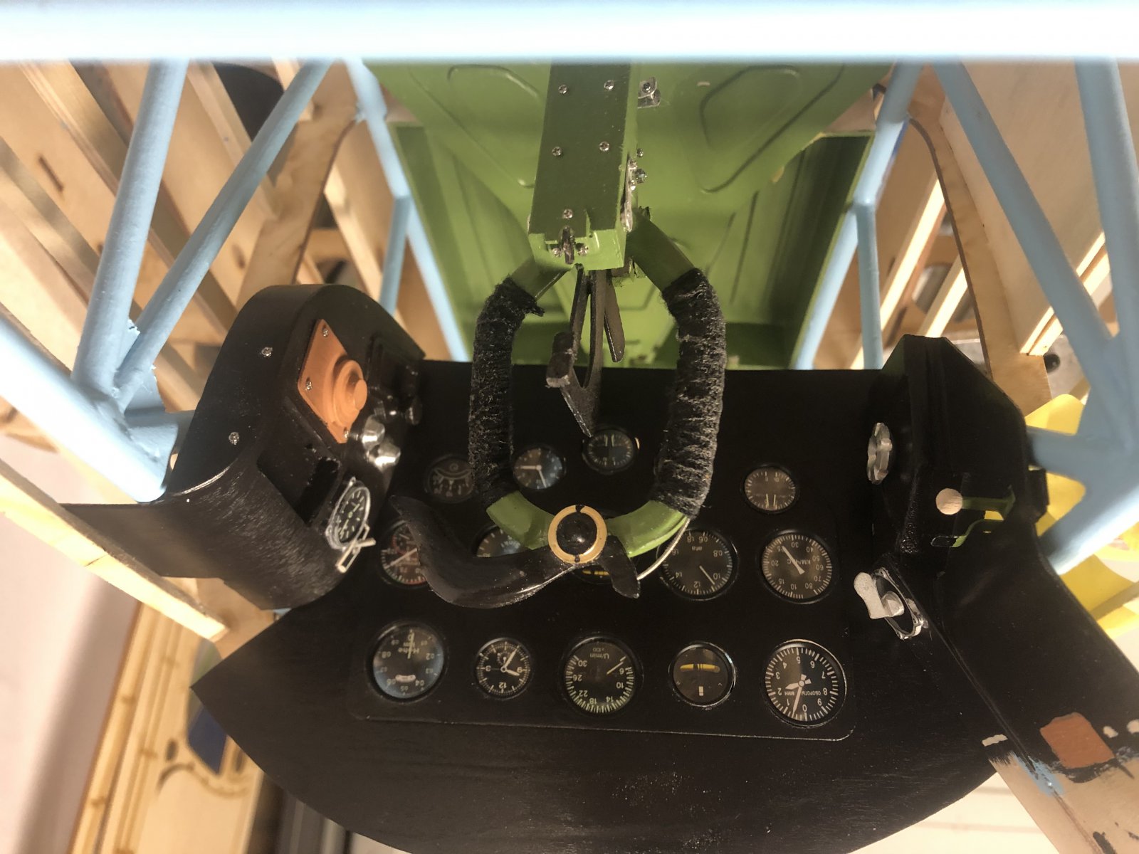

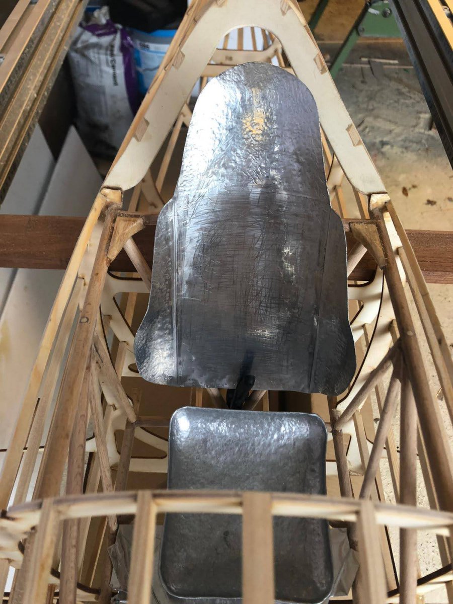

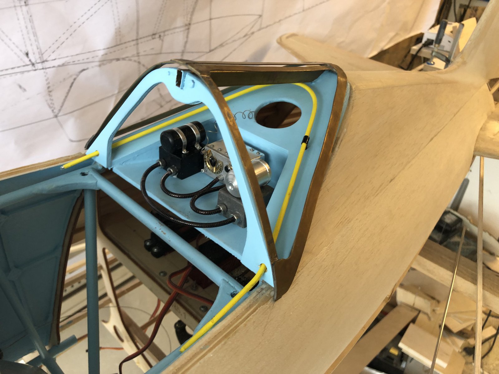

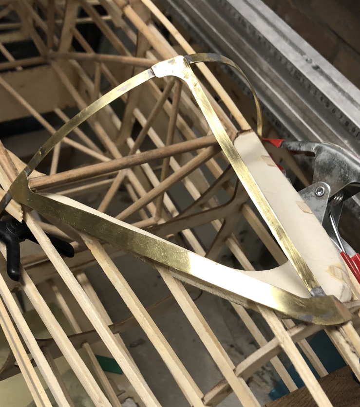

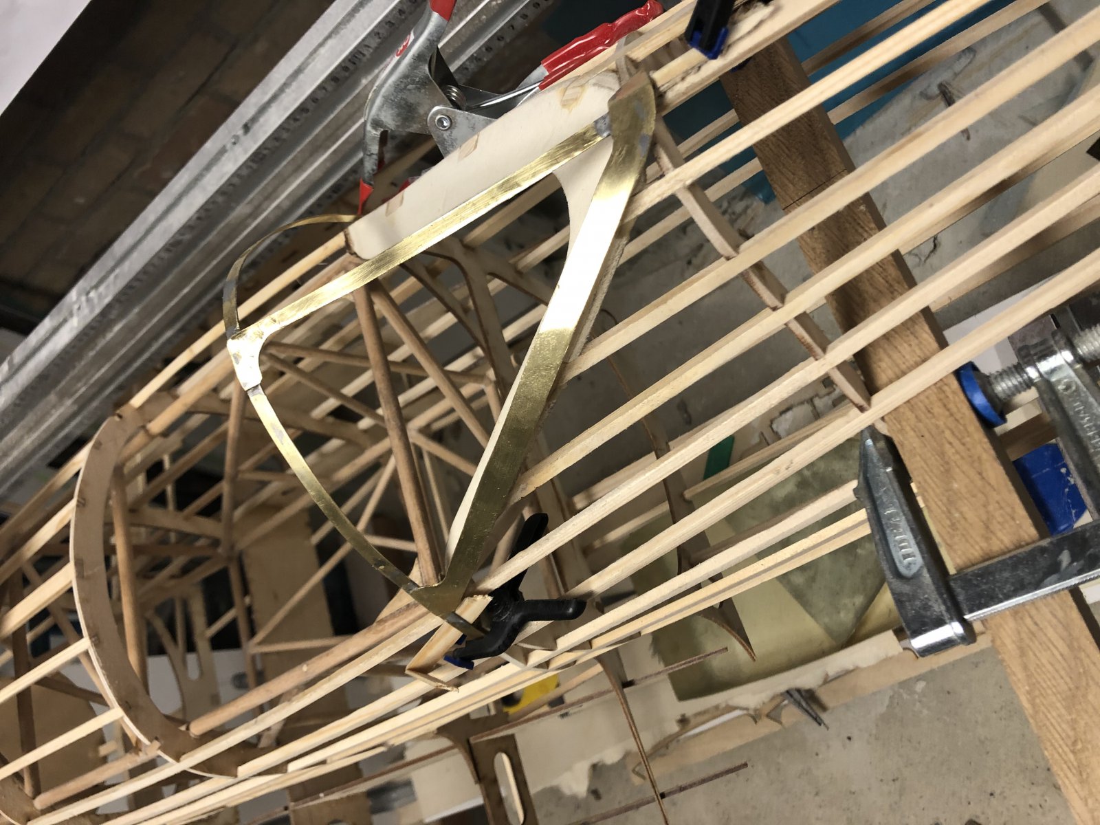

Bezig met cockpit constructie

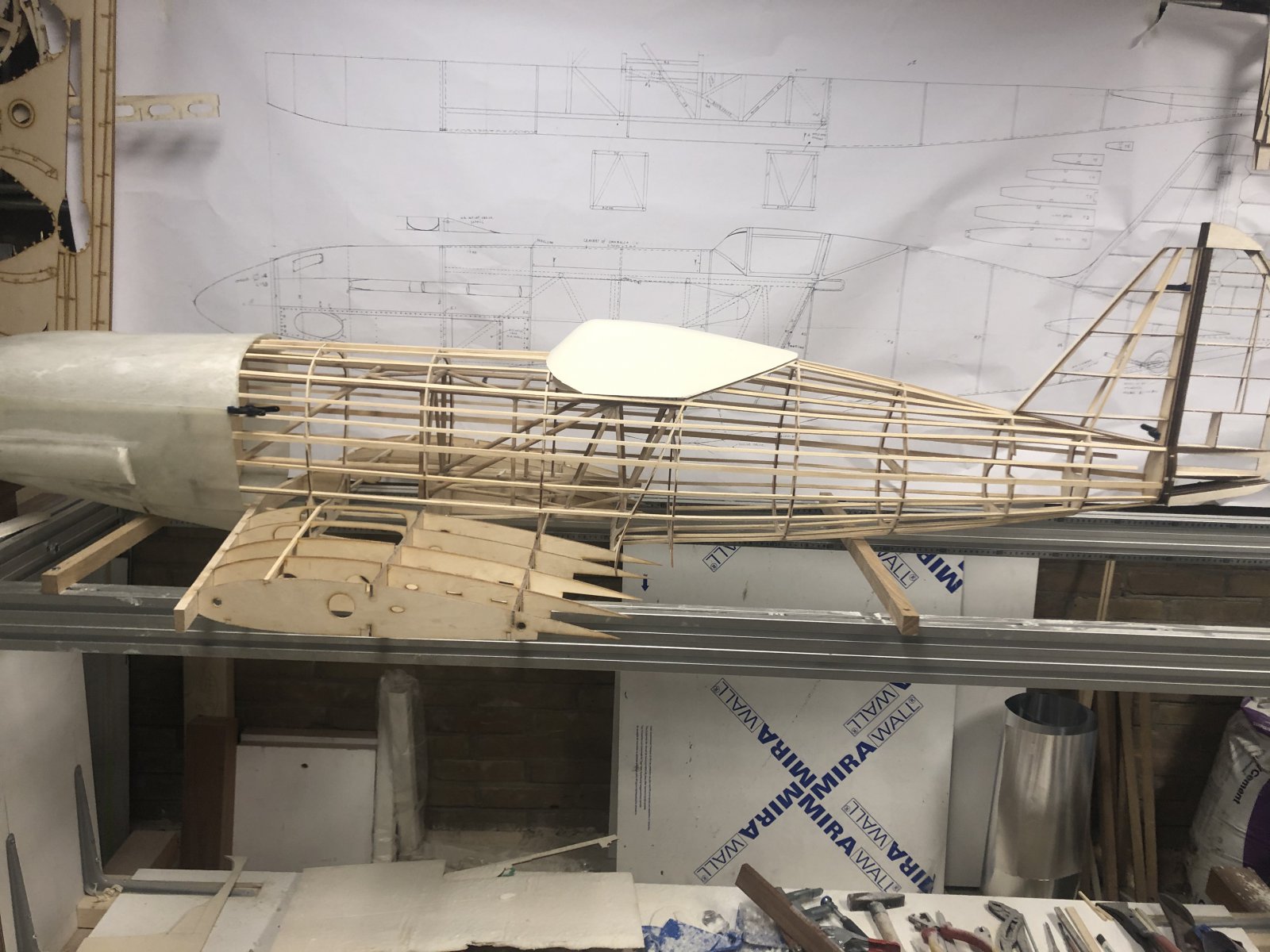

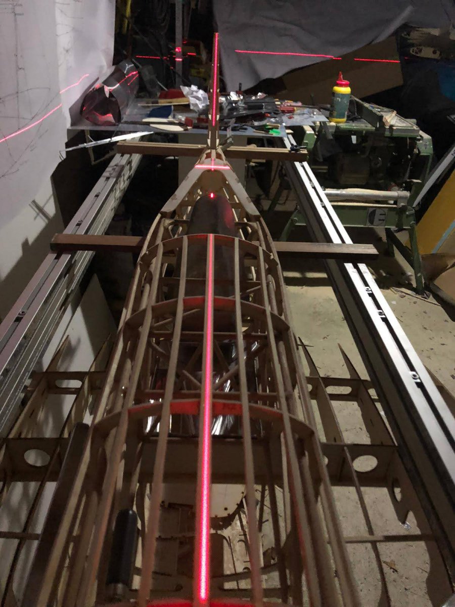

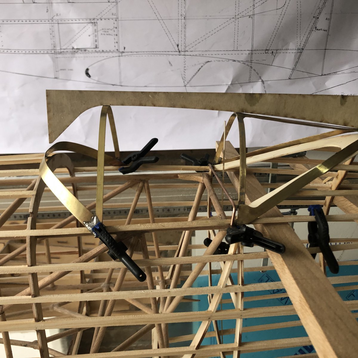

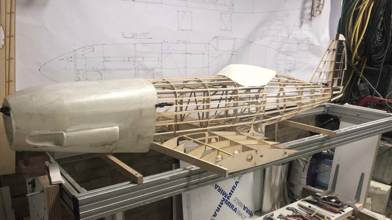

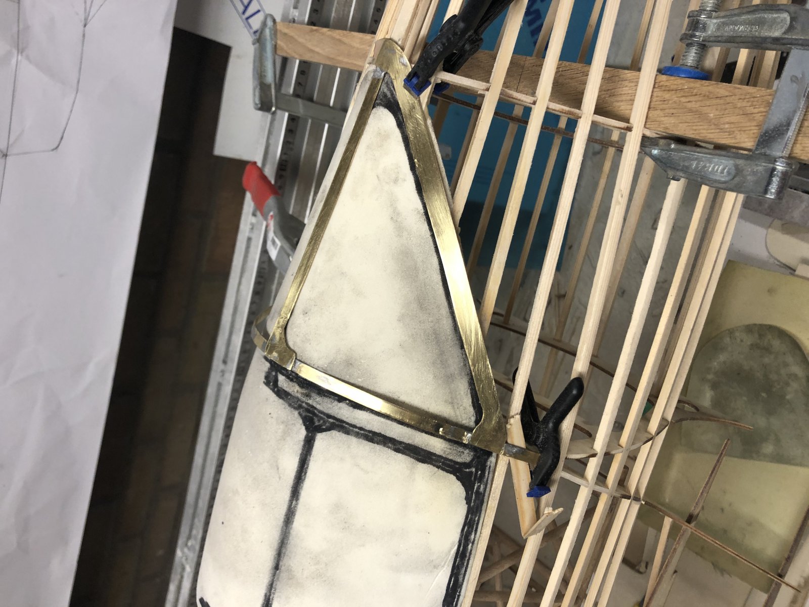

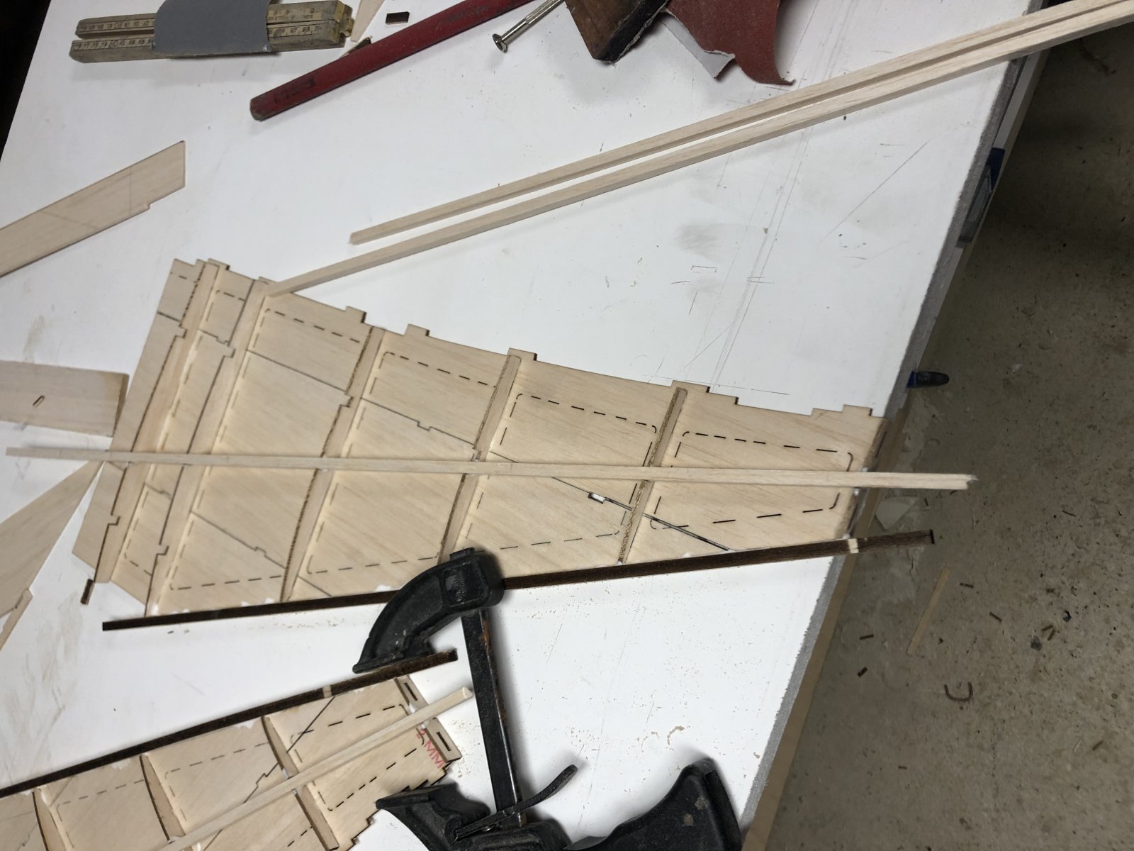

Weer lekker bezig geweest, stappen gemaakt

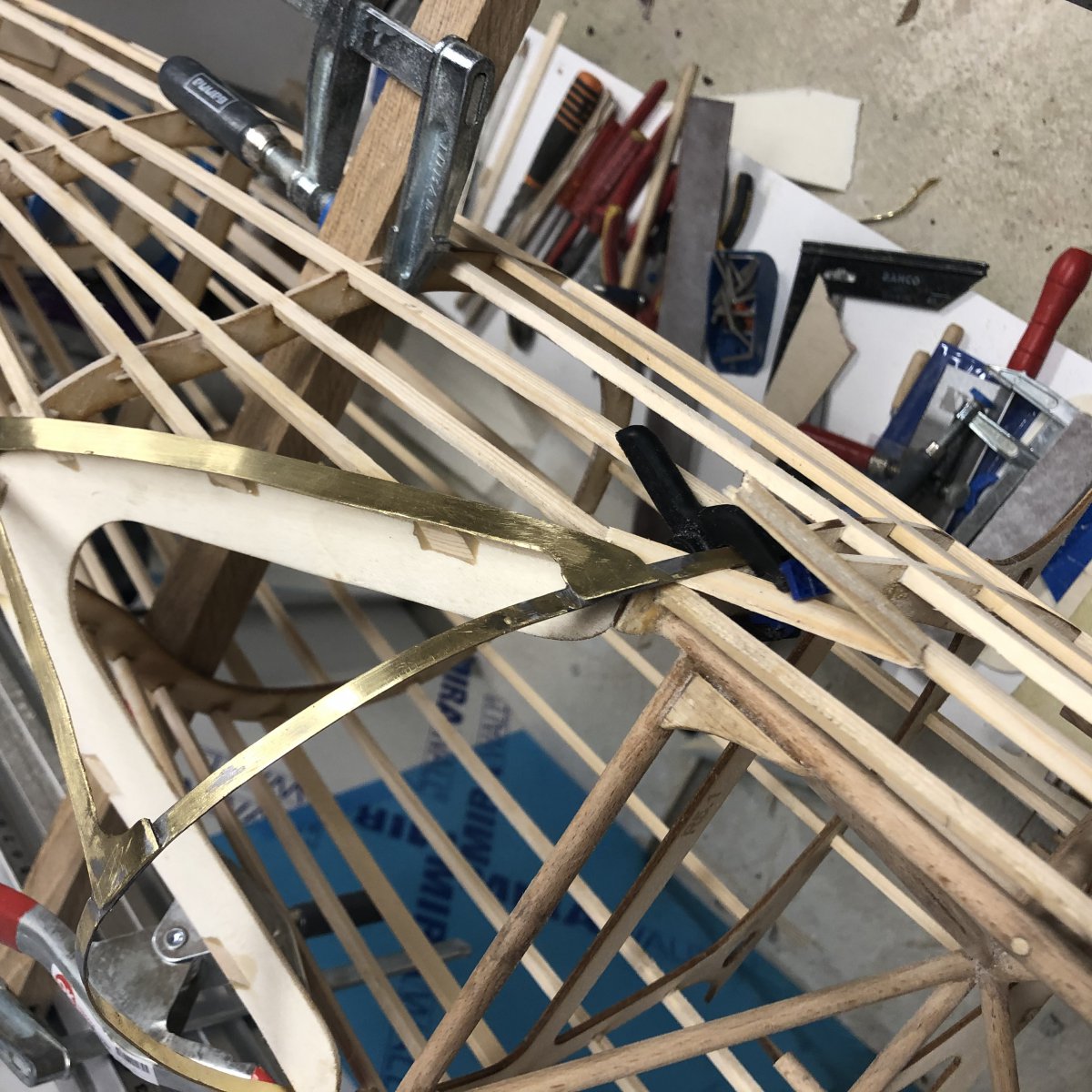

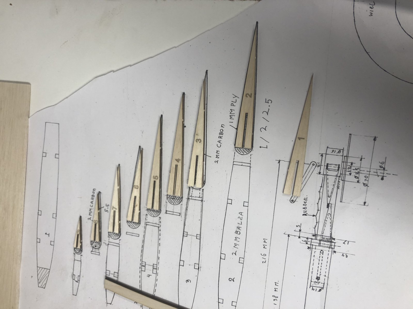

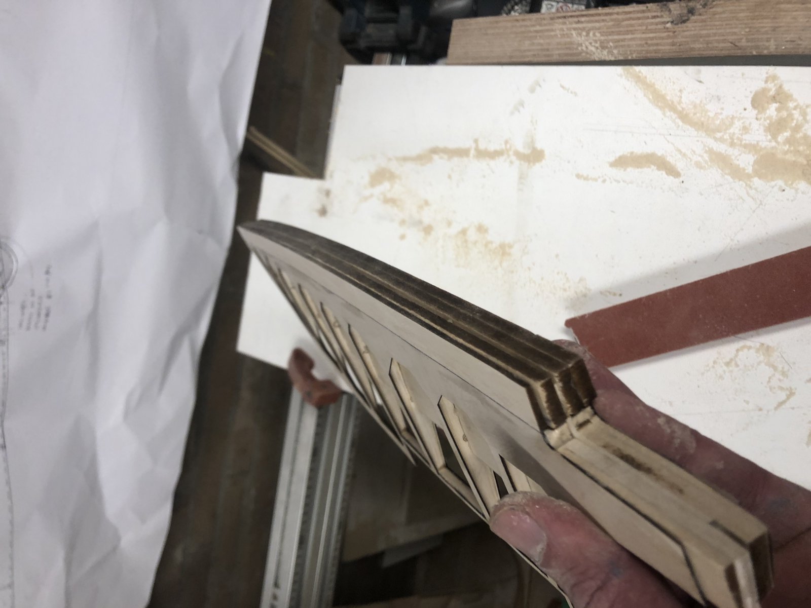

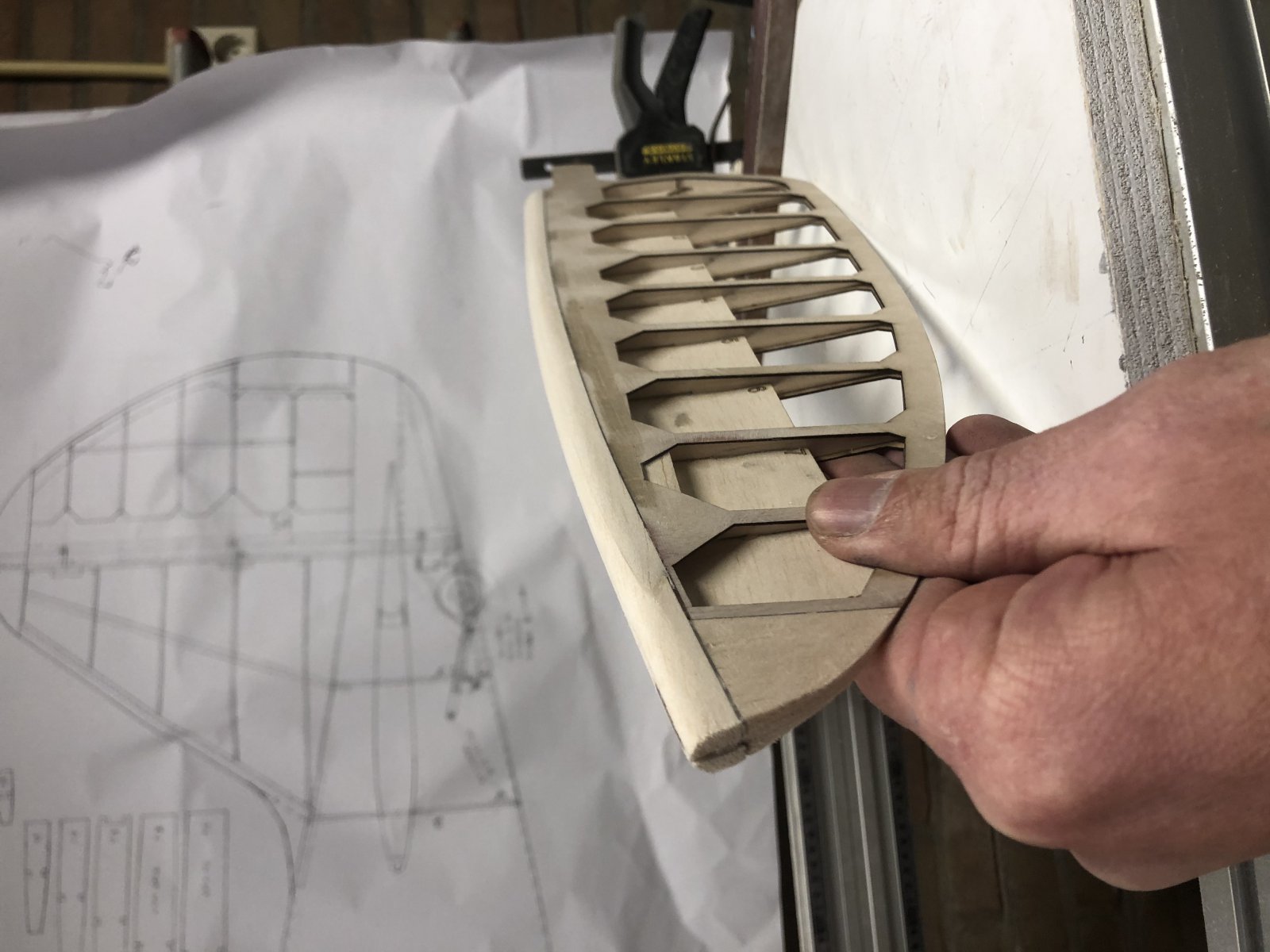

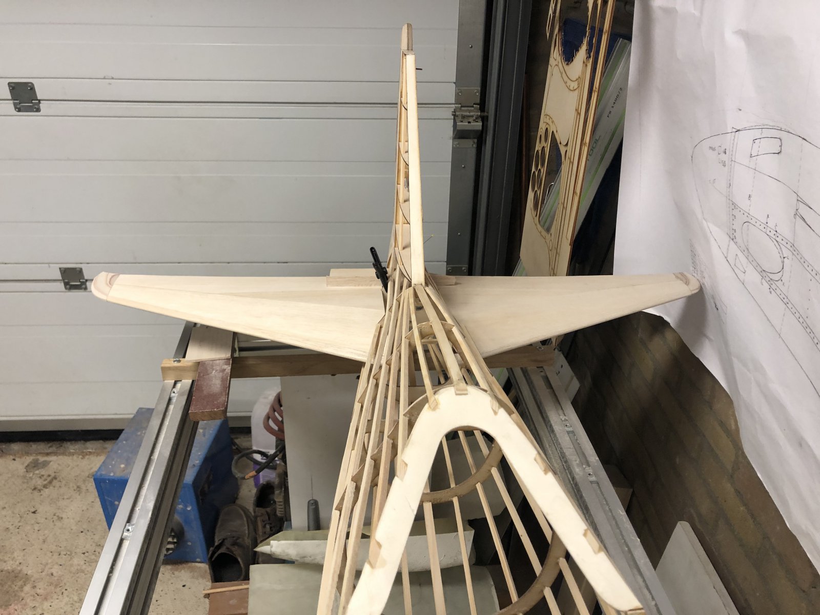

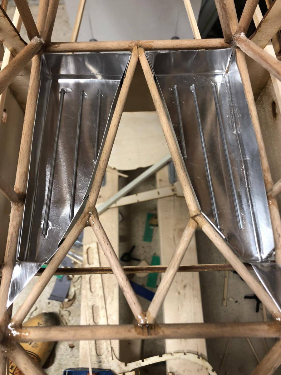

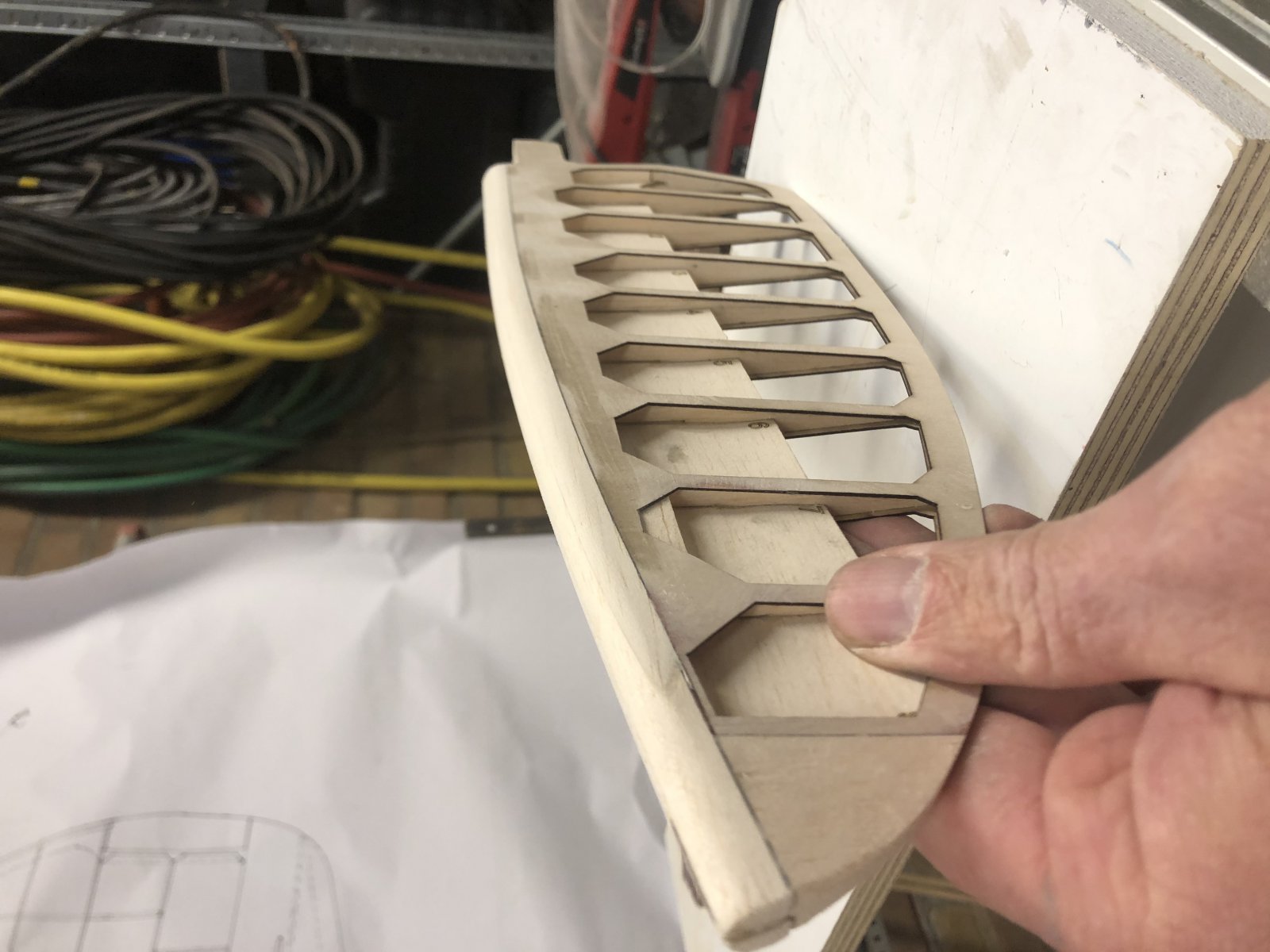

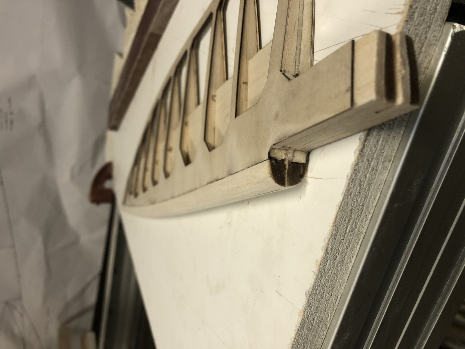

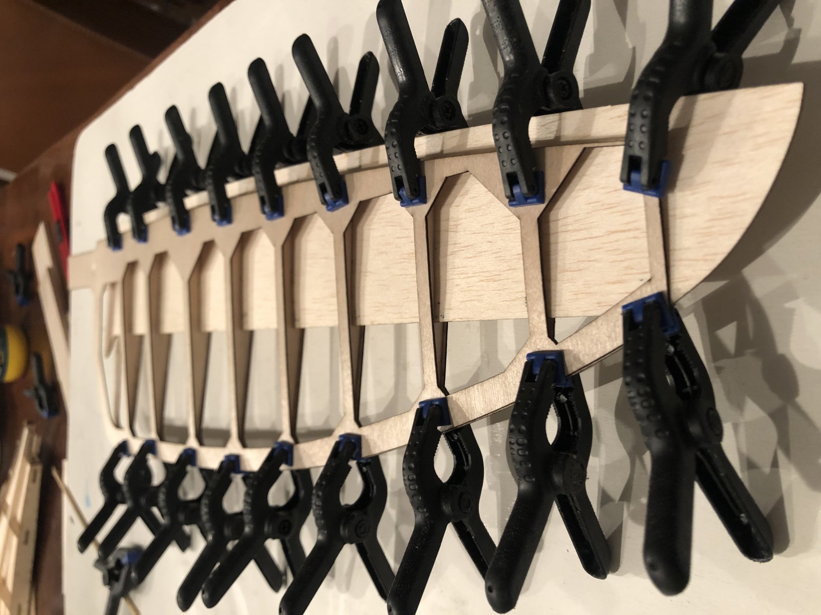

Mig 3 progress
elevator

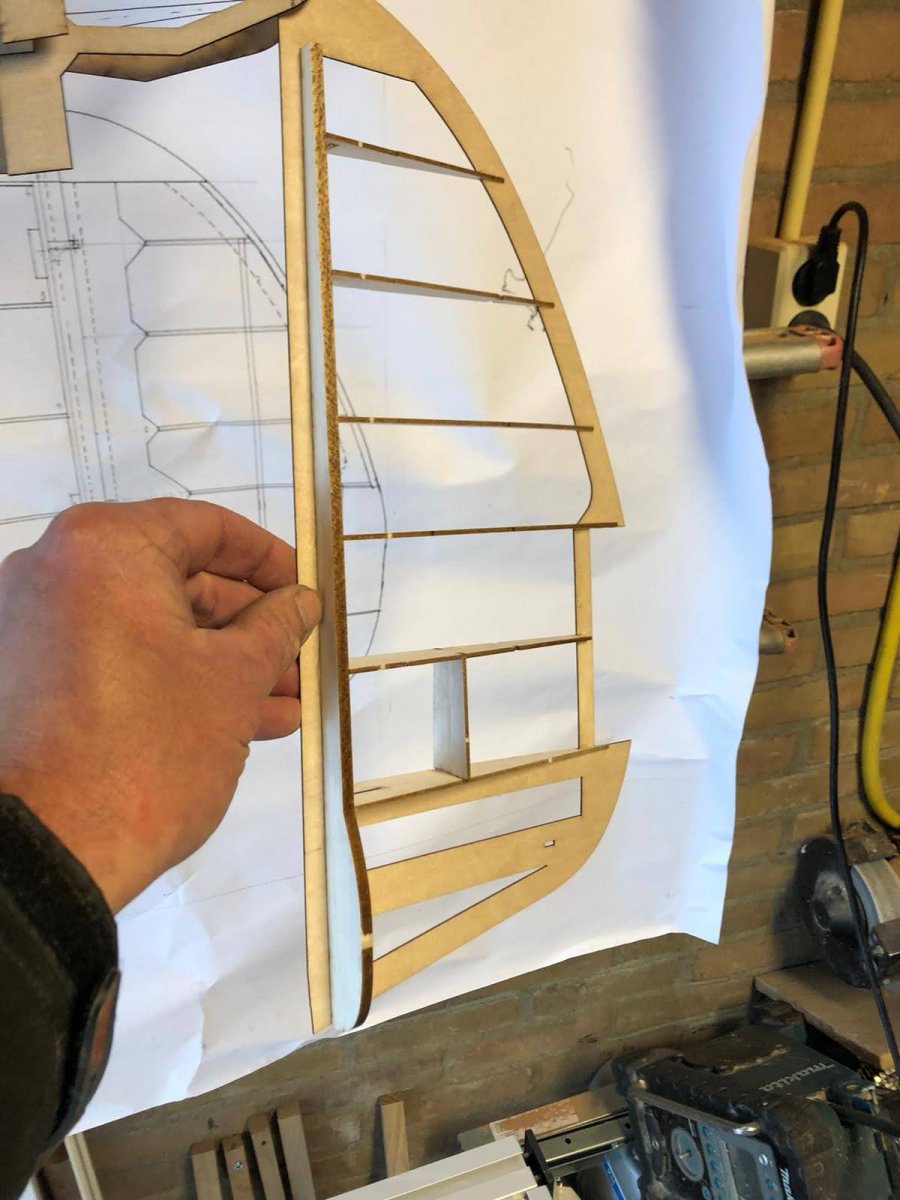

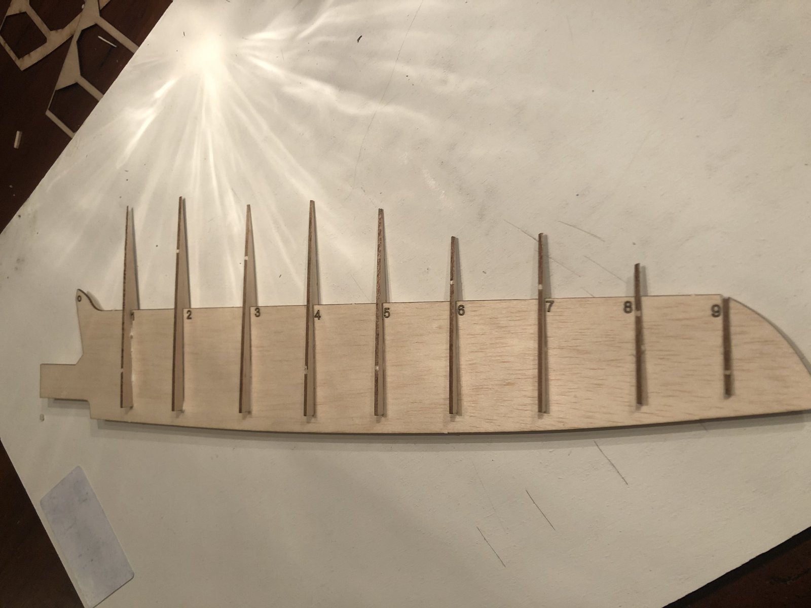

Step by step

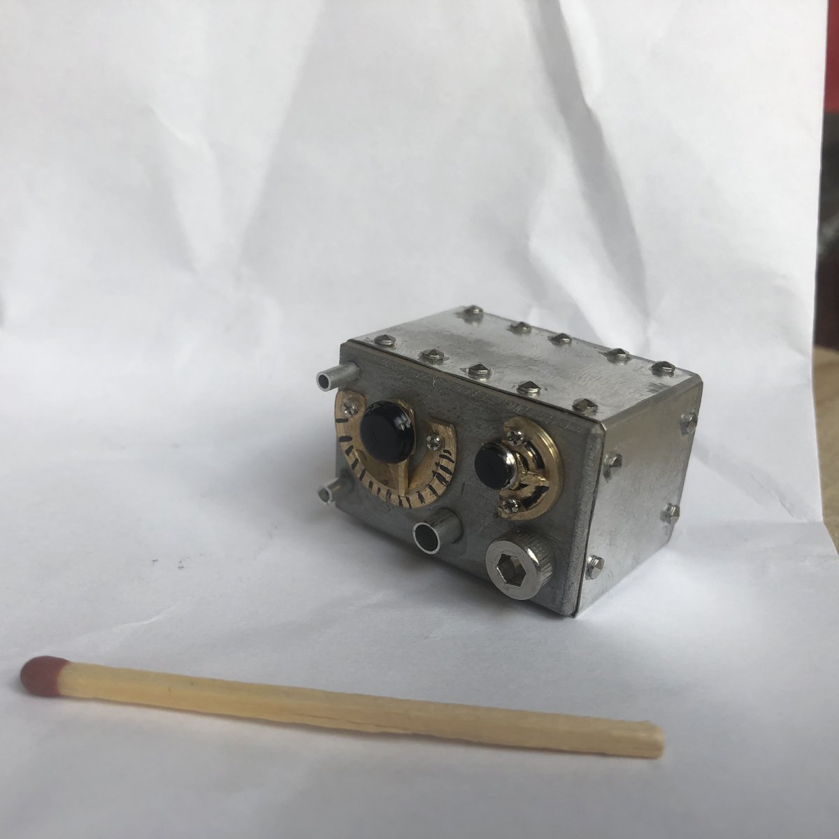

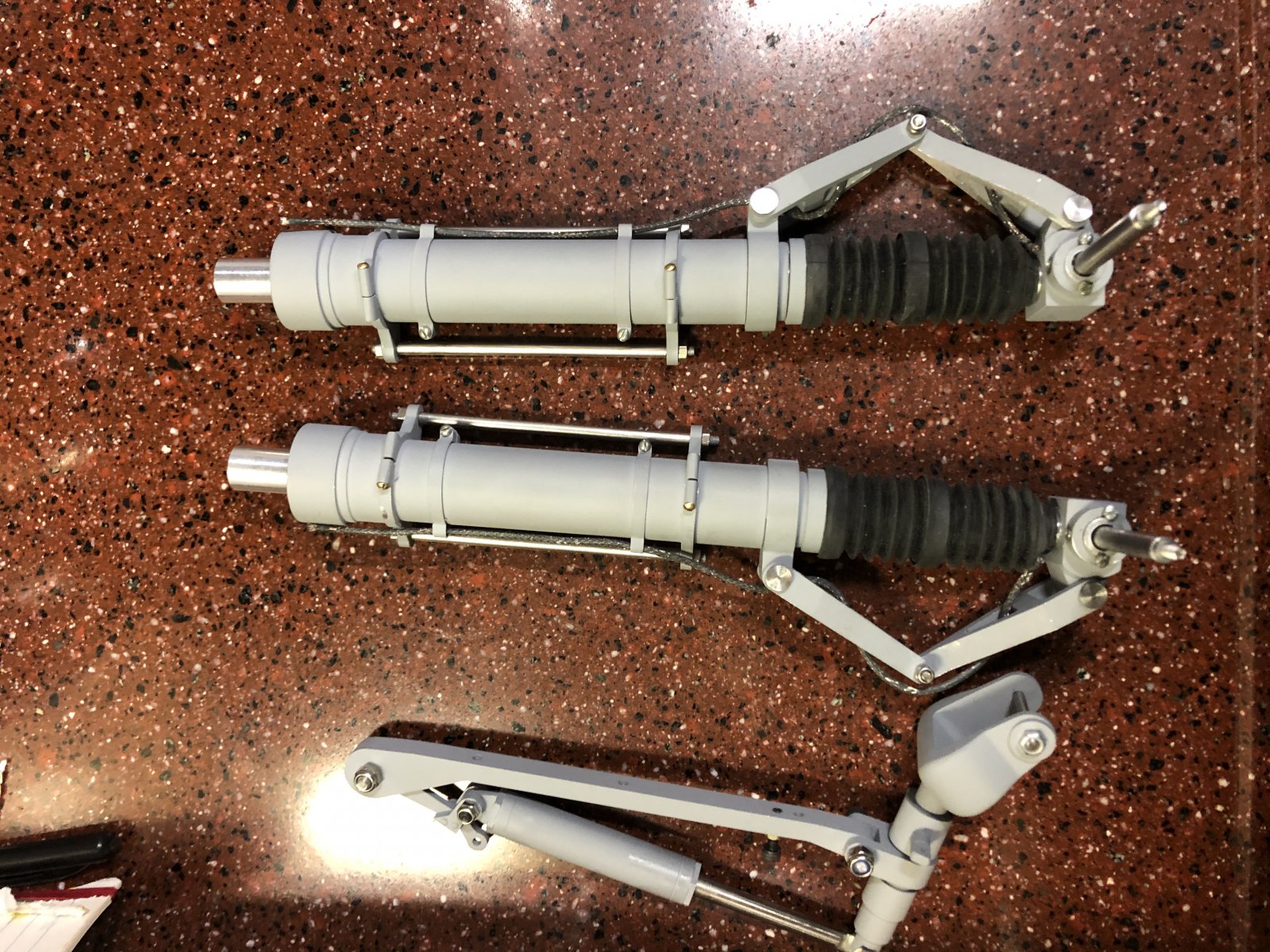

ondertussen zitten bij mij de poten in het model ik heb gebruik gemaakt van ER 40 junits van electron en eigen gemaakte poten
echter laten we de poten voor de YRM modellen nu maken in Armenie bij een persoon die echt heel erg goed is
maar die komen dus niet lekker uit met de ER 40 junits
draaipunt zit eigenlijk op de verkeerde plek
ik heb nu voor de mig3 een kompleet nieuwe junit ontworpen die ook geschikt is voor andere modellen waar datzelfde probleem het geval is
daar gaan we mee testen
de aandrijving van de ER 40 en ER 50 kan er op
en voor modellen tot 30 kilo

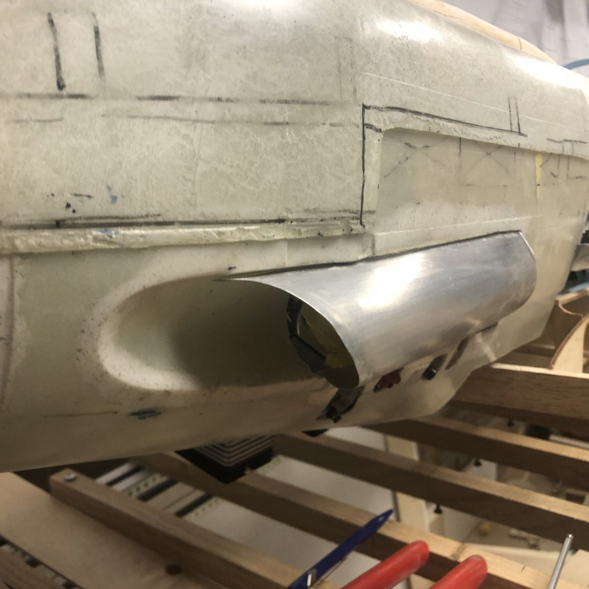

Tijdje geleden alweer dat ik de vorderingen plaatste.
